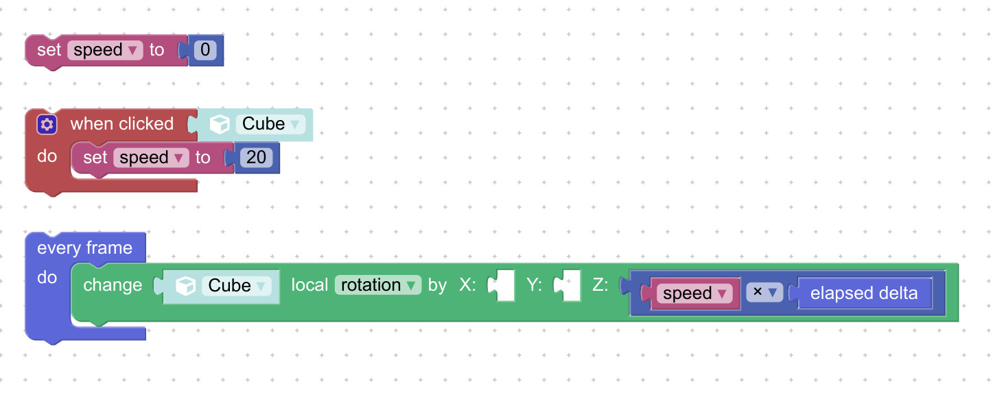

    how to rotate the object but not the camera rotating the object. I am building an AR project and I am creating a button to make the object (3D character) rotate. I tried to add autorotate camera to the puzzle in preview it worked but when I tried it on my phone it didn’t work

    Indeed in the AR mode camera is controlled exclusively by the phone. Instead you need to rotate the object (or the entire scene). Use Augmented Reality demo inside your Verge3D distro as an example.

    is there any possibility to auto-rotate my 3d character in AR? and if possible, is there a function in the puzzle? sorry i have only been using verge3d for a few days
    #40251
    Sure, check out the example below:
