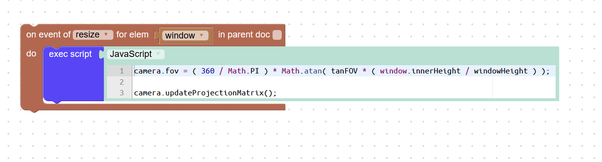

I am trying to make it so that if you resize the window of verge3d, the scene automatically resizes to fit the window. Right now, if I resize the window, sometimes parts of the scene are cut from view. Is there a puzzle configuration that can achieve this?2021-07-04 at 5:07 am #42513ccoul
CustomerCurrent puzzle setup that is not working:

GLiFTeKCustomerHi,
Try putting app.camera instead of jyst camera.Visit the GLIFTEK Verge3D Plugins Store!

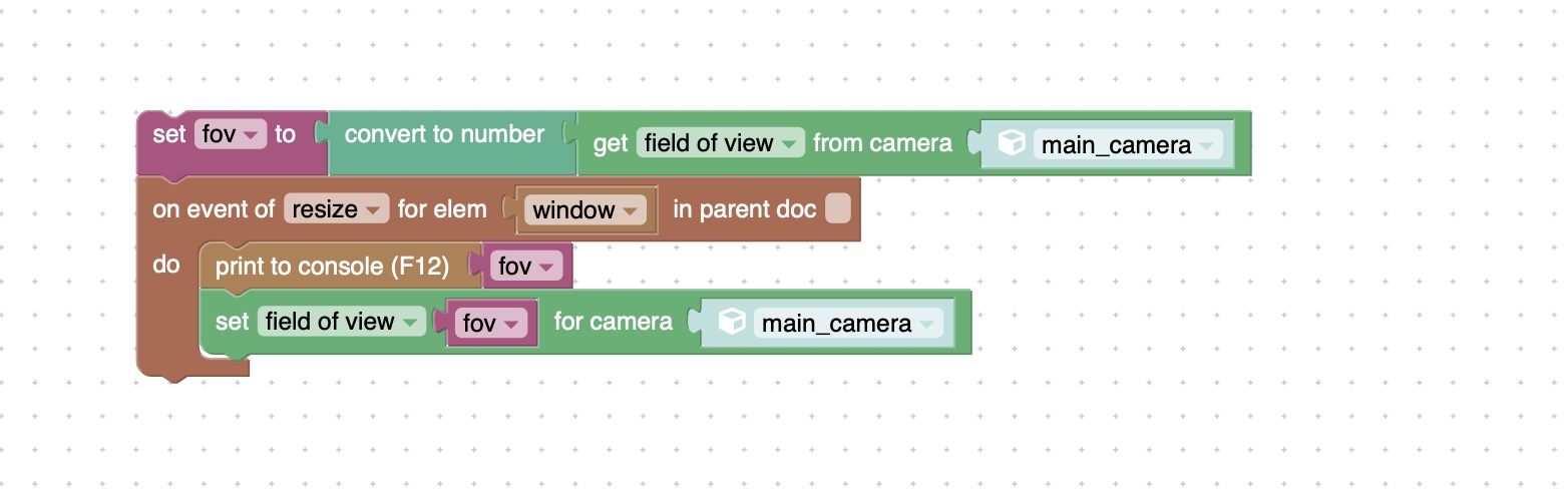

c4ccParticipantWhen I try to resize browser window with mouse, my scene’s otherwise hidden parts are showing as well. How do I get only the scene’s on-screen parts to resize together with the browser window, when the browser window’s being resized via mouse?
2025-06-22 at 6:47 am #82487
Alexander KovelenovStaffHi,
You might start with sensor fit. If the excessive objects appears at the left/right side of the viewport, set Horizontal. If they appear from the top/bottom side, set Vertical.

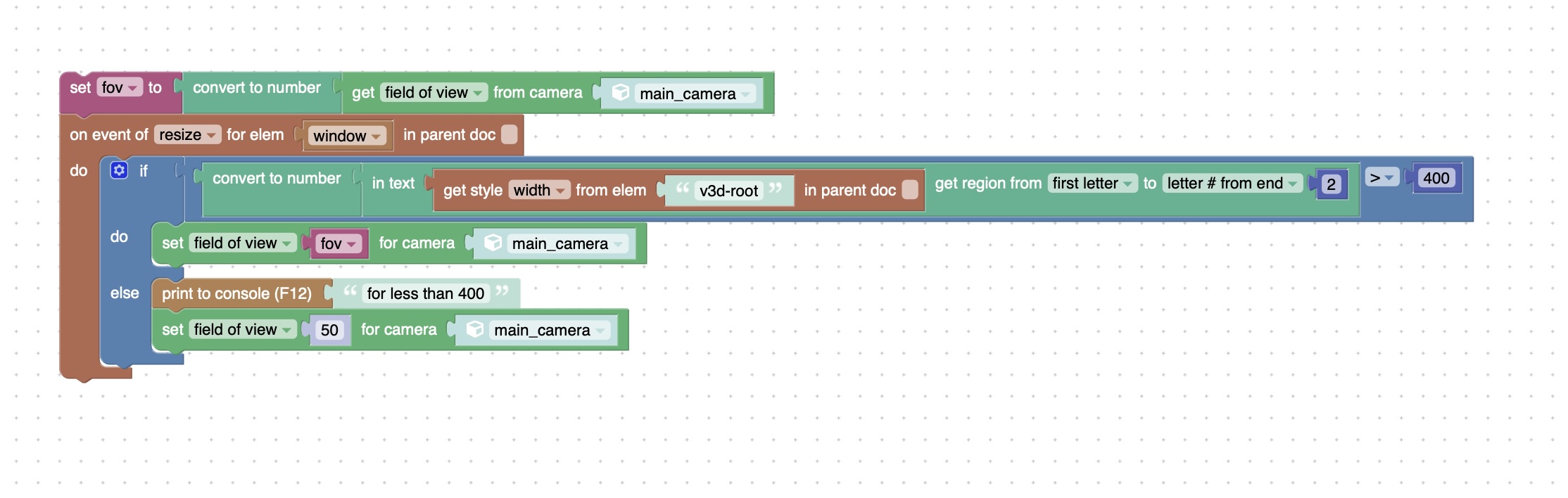

2025-06-23 at 5:29 am #82504bigmike814
ParticipantI messed around with it some more and don’t know if this will help, but it keeps it pretty stable. You might test the screen size and app a few different fov’s that will work for that size.

Alexander KovelenovStaffModifying fov based on width/height/aspect ratio looks like really nice solution to this problem. Also, there are visibility breakpoints available in Verge3D. They allow to hide/show objects based on the viewport parameters.

ParticipantI’m not exactly sure what the problem is but could you make the FOV dynamic by applying a value based on width rather than mapping it?
