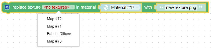

    Hey,
    How can we replace a texture when using gltf Material?
    The “Replace Texture” puzzle doesn´t show any textures.
    Is this not supported yet?

    The “Replace Texture” puzzle doesn´t show any textures. Is this not supported yet?
    Probably textures in your materials have no names.
    Testures without names cannot be replaced via puzzles.

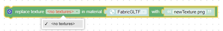

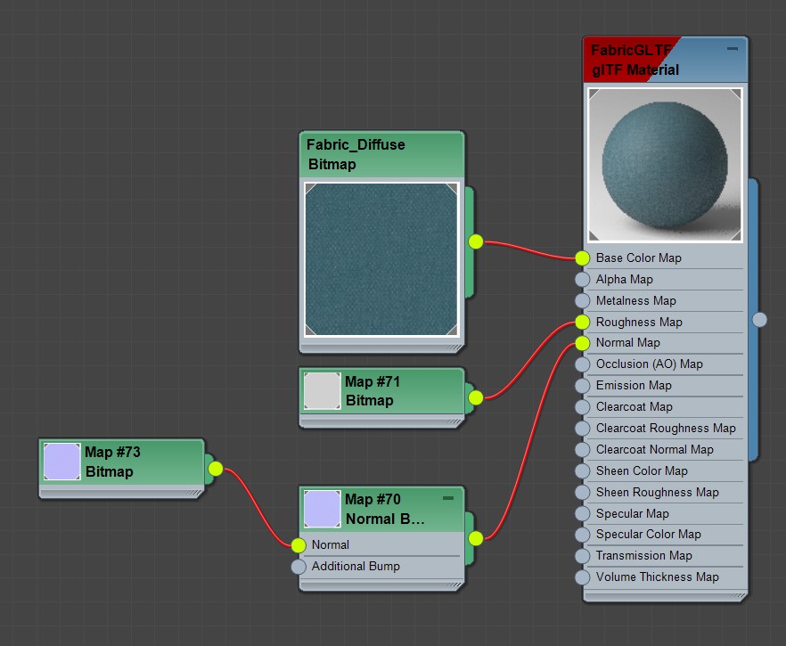

    Not sure where this screenshot is from, but I didn´t post any file.
    I´ve attached screenshots from my settings.
    If someone from the verge3d team could reply, I would appreciate it.
    Thanks!

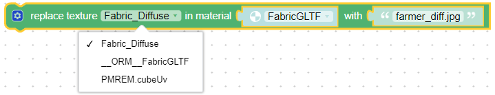

    The screenshot is mine, from my app ))) it just shows how textures are represented in standard materials after importing from .gltf.

    I modified the gltf_compat example file, now the app is just a box with this single material.
    I´ve attached the app.

    Sorry, I´ve uploaded the wrong version, Material#17 is a PhyiscalMaterial.
    Attached you will find the version with the GLTF Material.
    Thanks for your time and support! :good:
