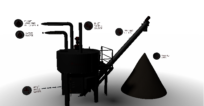

I have a client that is having issues with showing the presentations – the 3D-model is showing, but all shaders are rendering black (this is true for all examples on your site, and a presentation we are working on).
The laptop is a HP Pavilion g6-1018eo running Windows 10 – all Windows and graphics drivers are updated and browsers (Chrome and Edge) are also updated.
Please see the attached screenshot from the browser, and the attached report generated from Chrome (chrome://gpu/).

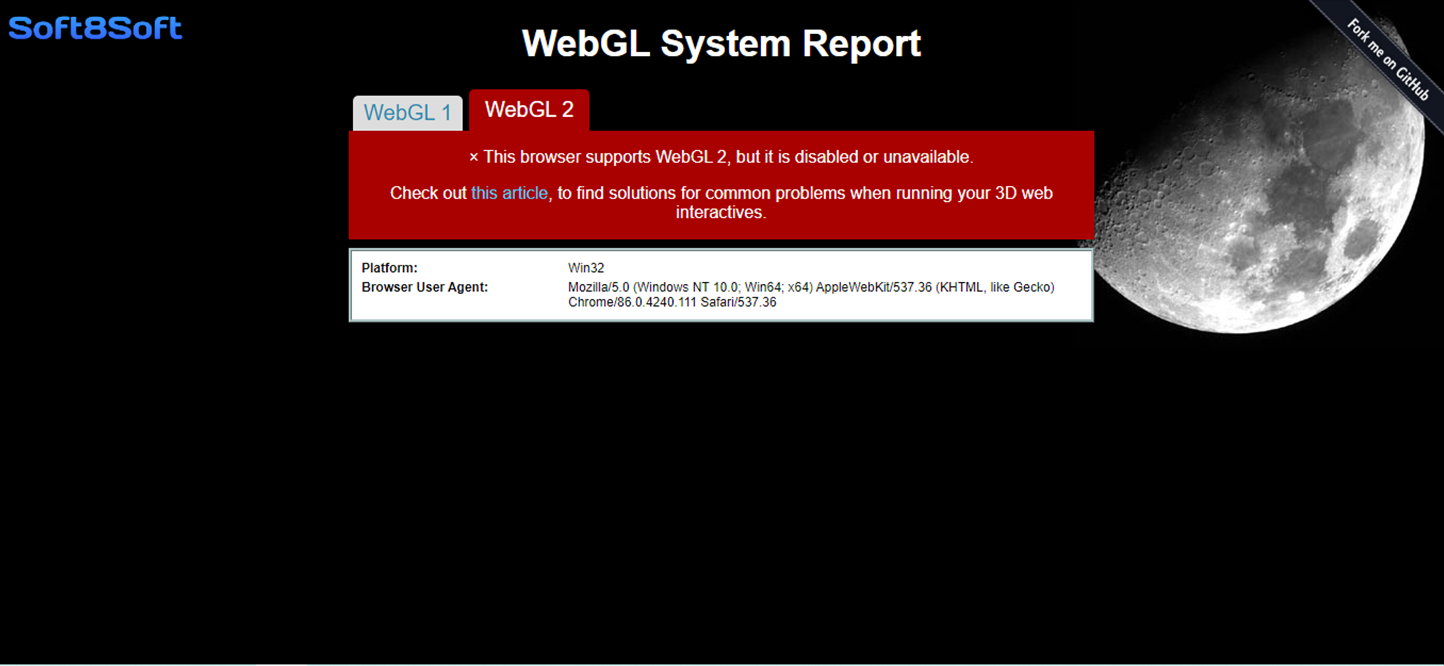

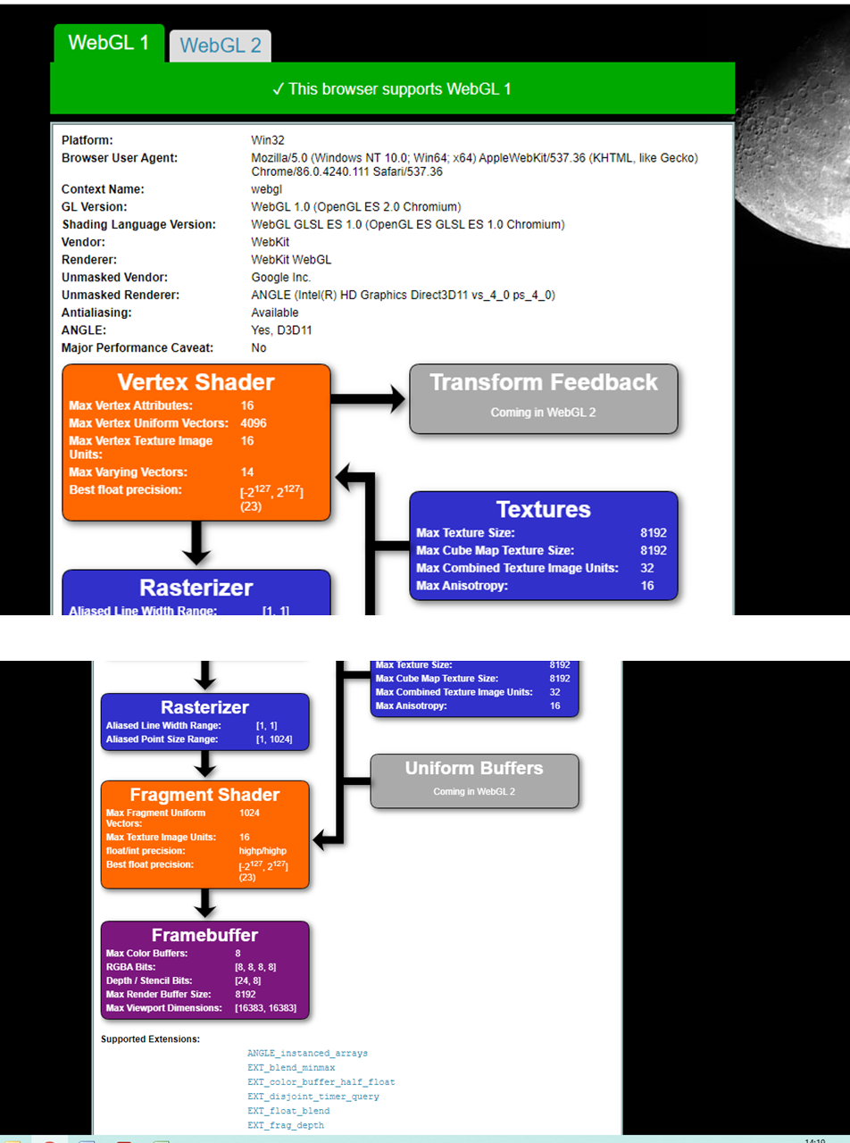

CustomerThank you for the reply – please see the report from Chrome below and the attached WebGL reports.
