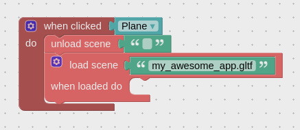

I’ve problem with to reload a scene.
I saw your example “load_unload”, but is not exactly that what I want.
In attachments image u can see ” menu ” of your example, but I’d like to have only a button “load scene” (possibly customized (like second image for example)) without list and selections, because I want reload the same scene…
newbie
EMMA2019-03-06 at 9:59 am #12212
Yuri KovelenovStaffSorry for the confusion caused. Actually, you can unload the main scene using a blank Text puzzle, and then load it again by its name.
If you’re using HTML-based UI and not a 3D plane object, just use the HTML event / click puzzle.

2019-04-03 at 5:22 am #13523daveli
ParticipantHello Yuri Kovelenov:
I want to initialize the scene. For example, after I did some work on the scene, I want to erase all the processes and restore them to the scene that I just started loading. I tried your suggestion and used the jigsaw to unload and reload the scene, but there was a short black screen in the process, which was a very bad experience. I want to have a puzzle setting that can initialize the scene with one click, so that everyone can easily use this feature.
Daveli
2019-04-03 at 8:10 am #13531
Yuri KovelenovStaff2019-04-03 at 10:02 am #13536daveli
ParticipantThank you! At this stage, your suggestion is indeed a better idea.
