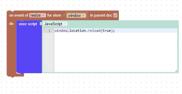

I need to refresh the page after the user changes the orientation of the mobile device. This needs to be done because the different interface is designed for landscape and portrait. I created the interface in Webflow.I’m trying to do it with the script (the puzzle configuration is in the attachment):
window.location.reload(true);but it reloads the html_embed window only (so only the Verge application), but the elements added via Webflow stay the same.
How should I configure this code to reload the whole page including the app embed and the Webflow elements?
2022-10-05 at 9:03 pm #56418kdv
Participantparent.window.location.reload();but it’s a cruel solution to reload the whole page: one awkward move and ooops ))) can’t you just hide/show interfaces on the window resizing?
2022-10-06 at 6:59 am #56420Mariusz
CustomerThank you, it worked!

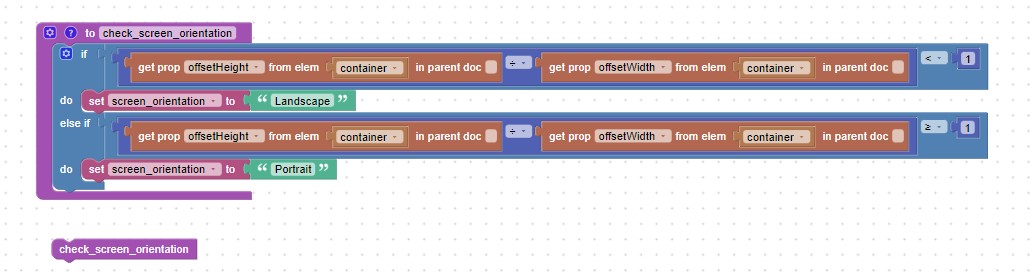

2022-10-14 at 6:02 am #56626Mariusz
CustomerI’ve just found a better solution to the problem that I had. I managed to display the “rotate the device window” message for the user when he rotates the mobile device to landscape and I want him to stay in portrait. It’s a kind of workaround.
I’m leaving it here in case someone will need it in the future.The reason for this workaround is that resizing the window from the example above was working also in a case where the user uses the “input” field to enter some text – the window was resized on mobile because the keyboard appeared and the website got refreshed, which was wrong in this situation.

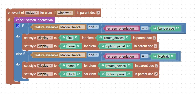

To make the workaround:
1. We need to create a div with the message. In my setup, it has an ID “rotate device”.
2. We need to set up the procedure for checking the screen orientation (it was explained by Soft8Soft in a few places on the forum).
3. We need to set up “on event” for resizing the window. -
