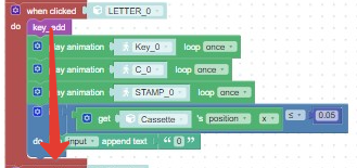

    At the moment, it’s set up so that each press of a key on the onscreen keyboard types the same letter in the text box but, for reasons I cannot fathom, it will only type the first letter you press after you’ve typed a second letter, and so on down the chain.
    ie. press ‘E’, nothing appears, press ‘T’, ‘E’ appears, press ‘Y’, ‘T’ appears, etc etc.
    How do I go about setting up the puzzles so that the letters appear as they are pressed?

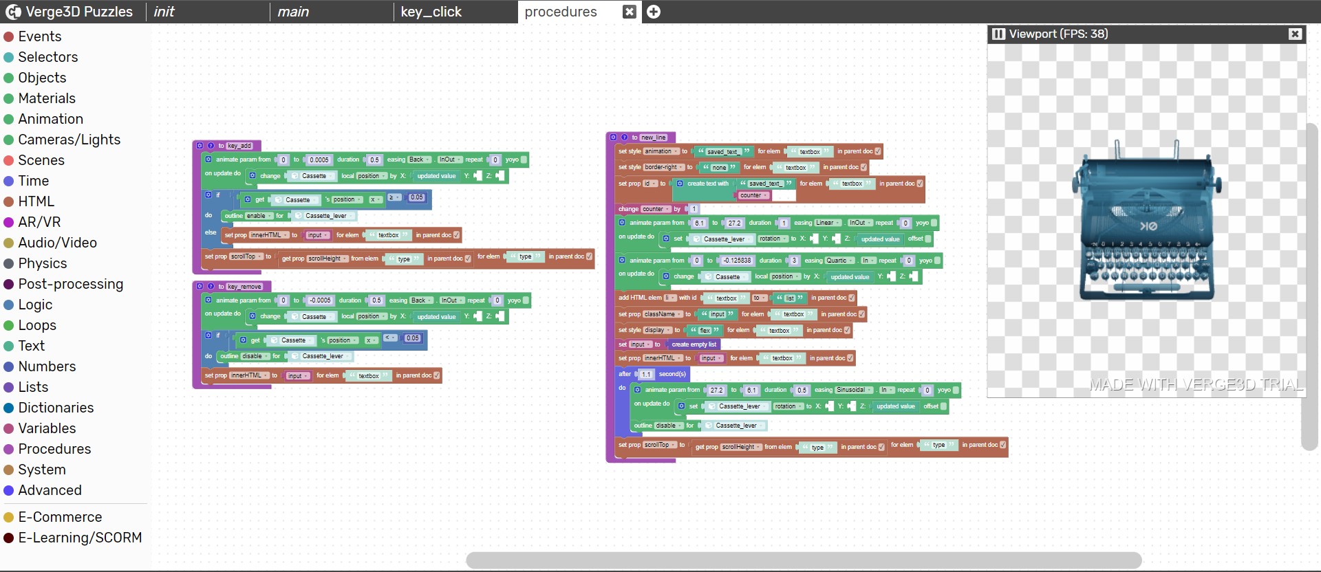

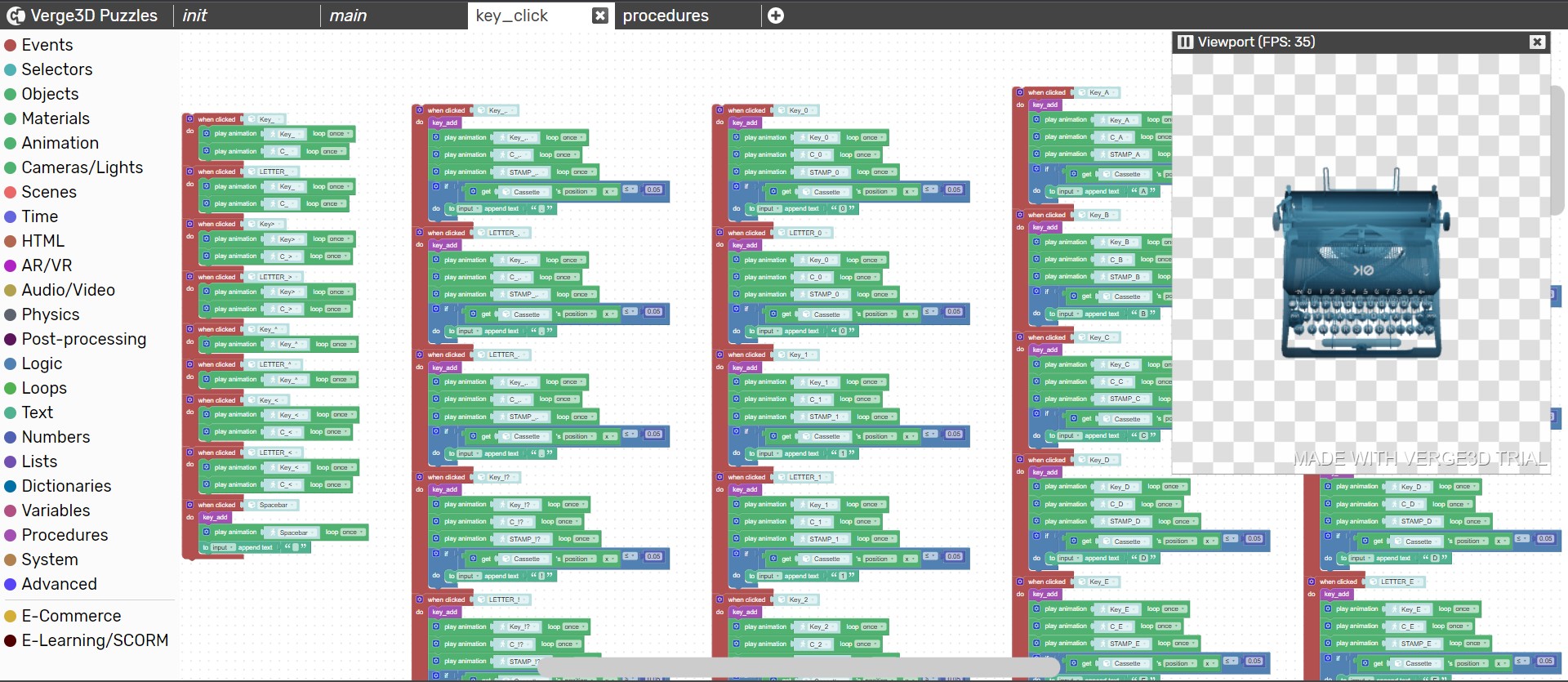

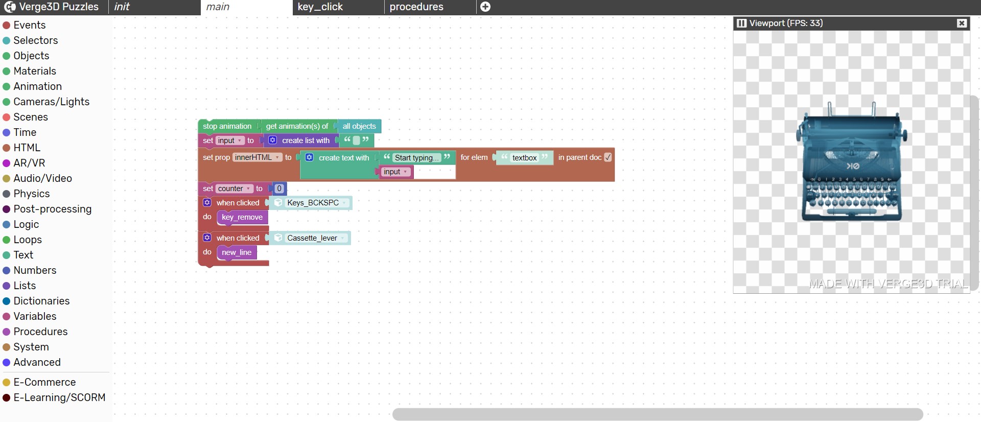

    I’ve included a link to the project file, and some screenshots of the puzzles which makes it {almost} work, below.
    Move the key_add procedure to the bottom. It should be called right after updating the input variable. Not before.
    #63604
    kitt
    You’re a saint!! Thank you so much, that works perfectly now.
