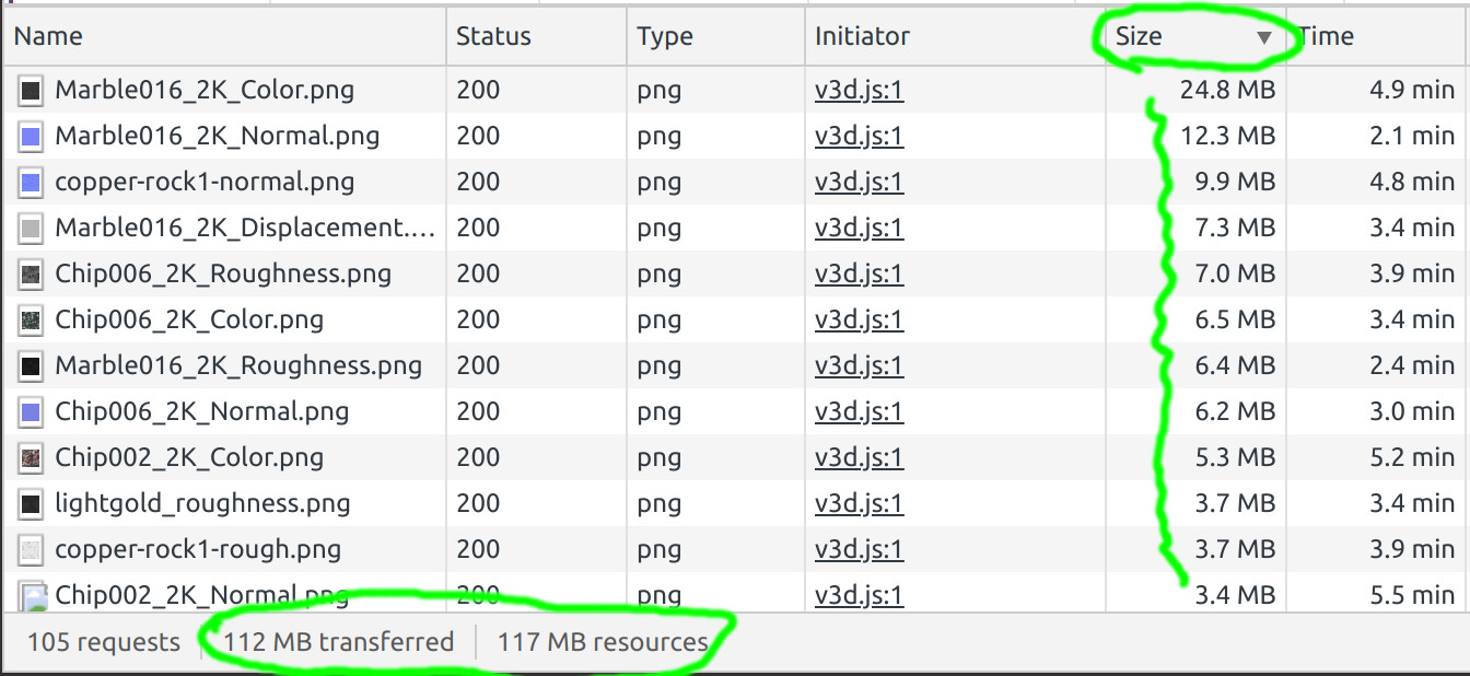

    I checked browser console (opens with F12) and it looks like your app is very big in file size. There is certainly room for improvements, making textures less and converting them to jpg. You might get rid of some non-essential textures altogether. Try to make it under 20 Mb.

    I haven’t updated the website to reflect the optimizations I’ve done yet, so the website shows the app to be 100+ Mb whereas the optimized version is around 17 Mb. I do know there are more optimizations to be done with my textures and such, but is there anything else that can be done on top of that? I would assume reducing the app size by ~85% would reduce the loading time a lot more than it has, so I’m wondering if there’s something else going on that’s affecting the loading time.

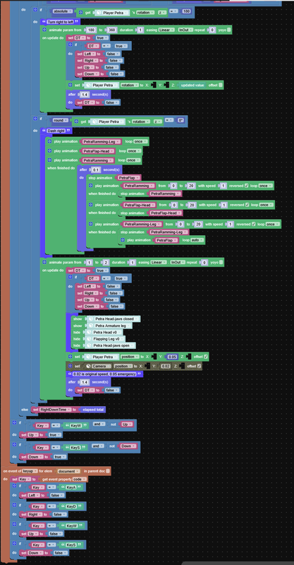

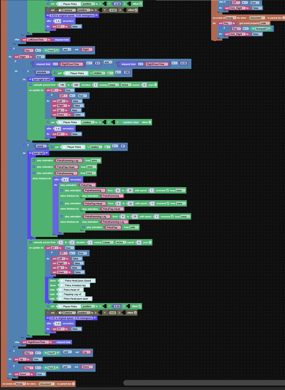

    Are there any good tips for making puzzles to try to keep the loading time down? After messing around I noticed the puzzles seem to have a heavy impact on performance.
    I know this question is old, but I also suspect puzzles may affect user performance, especially loading time and fps. When I saved my blend file as into a new project’s blend gile, fps was actually between 90-120. Then when I saved my xml to the new project’s, suddenly the fps dropped till 20fps.
    Any way to have a lot of puzzles without it affecting the user performance? Why weren’t we told that puzzles can affect user performance too?

    My code. How do I know if it’s causing performance issues, especially if it’s for user end?:
    #77600
    If this shows all the puzzles in your project…you can be certain that the quantity of puzzles is not the issue.
    You have a few tools available to you. One of the best tools is the Developer Console that allows you to see all sorts of performance, memory and other attributes that will tell you how your application is performing. You have also V3D built in tools that can help as well.
    If you model without any code lodes and performs well then you can be pretty certain the issue relating to performance is your puzzles.
    I do not know your project well enough to say what has to be done via every frames vs a timer vs another way. But given the code puzzle organization I guessing there are events firing mutliple times and animations are being called while in the process of other animations or before they have completed and memory runs out.
    If you want to share the project files.. I could take a quick look this week.
