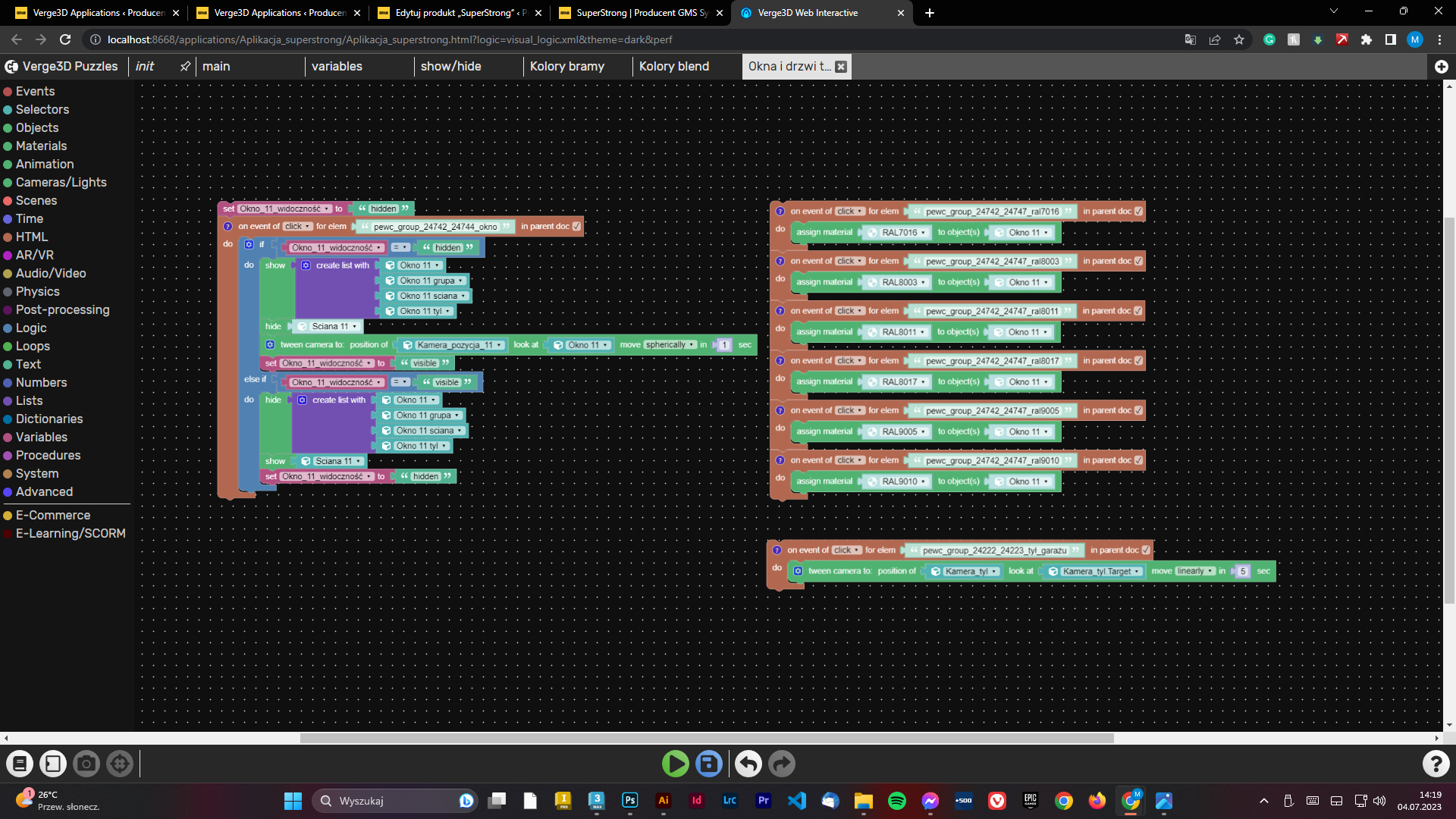

    Hello. I have a problem with puzzles . I have tried with multiple solutions and none seems to work.
    You can check it out here : https://gms-system.com/en/produkt/superstrong/
    Go to “Passage window/door — > the back of the garage –> position 11 –> window.
    When you check it, it should appear – when you uncheck it should dissapear. Thank you
    Puzzles Attached below

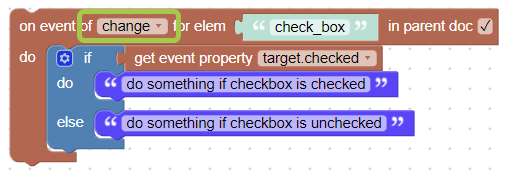

    Use this puzzle to see what’s happening when you click the “Window” button
    Btw, your button is not just a simple div, it’s an <input> element (a checkbox). So try to change the event type from “click” to “input” or “change”

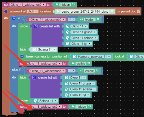

    Hello. I did that with “intput” and “change” It prints anything just when the checkbox is selected. When it’s unselected it does not do anything :( For example
    1st click (checking the checkbox) – ok, window appear
    2nd click (unchecking) – nothing happens
    3rd click (checking) – not ok, window hides.
    In console it looks like it
    1st click – visible
    2nd click – nothing changes
    3rd click – hidden
    4th click – nothing changes
    5th click – hidden

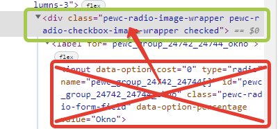

    Think. Keep on searching. The problem is in your a little over-complicated site structure that you can’t control. Try to change the target to this div (and give it some id)
    Or try to change the input type from “radio” to “checkbox”. The “radio” input works only if unchecked. If already checked it will do nothing when clicked again.
