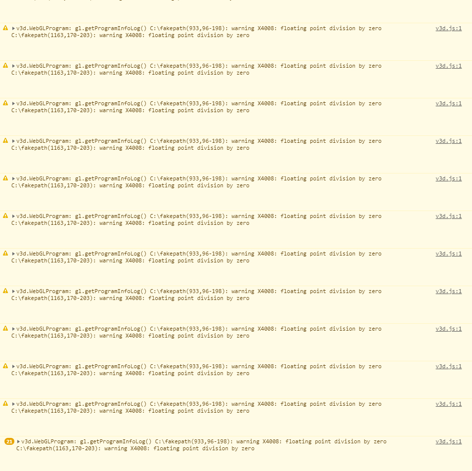

    Hi, first of all I would like to congratulate this community and verge3d.
    I need to solve a problem that breaks out the first time the scene is loaded with the browser (except safari). this message appears repeatedly in the console which greatly slows down the loading:
    3d.WebGLProgram: gl.getProgramInfoLog() C:\fakepath(933,96-198): warning X4008: floating point division by zero
    C:\fakepath(1163,170-203): warning X4008: floating point division by zero
    Eo @ v3d.js:1
    Co.acquireProgram @ v3d.js:1
    Se @ v3d.js:1
    (anonymous) @ v3d.js:1
    setTimeout (async)
    setTimeout (async)
    setTimeout (async)
    how can i solve? ty

    I found that the fakepath erroe on the console appears if there are materials created with texture images in the scene. where am I wrong?

    hi, I found out what was bothering me. the material I made had the texture linked to Principle BSDF inside, and this gave the error. I took it off and now ok. thank you very much for your availability :good:
