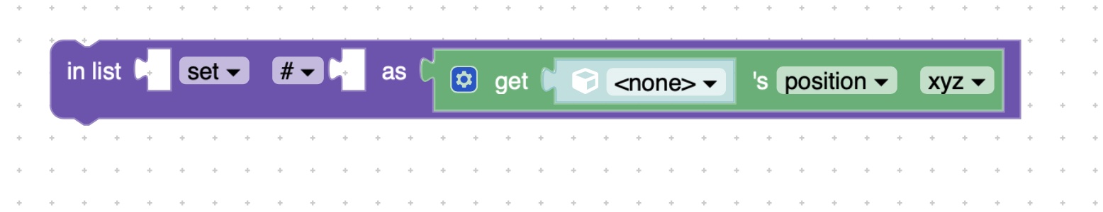

2023-11-13 at 4:01 am #68448bigmike814
Customeryou set get location as a vector and are assigning the data to the y and z. You need to change the set position to an xyz vector or get the y and z when moving if that’s what you’re wanting to do.

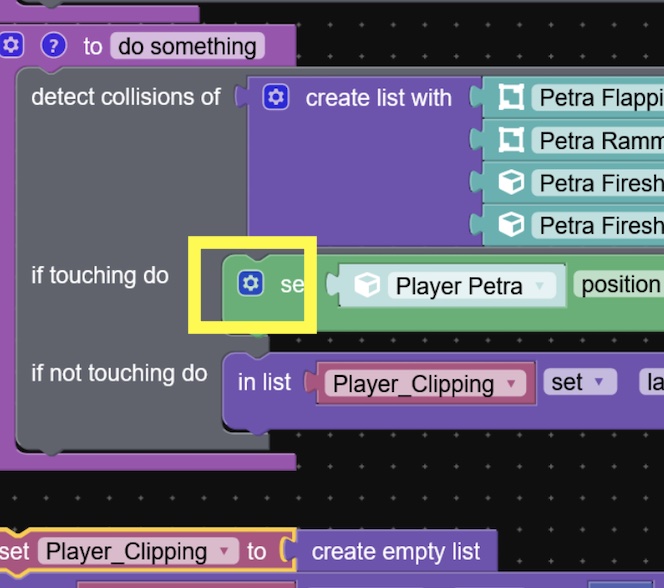

2023-11-13 at 2:37 pm #68493
c4ccCustomeryou set get location as a vector and are assigning the data to the y and z. You need to change the set position to an xyz vector or get the y and z when moving if that’s what you’re wanting to do.
I tried this, sadly, it didn’t work:
Also, why does the fps severely lag whenever my objects touch each other?
2023-11-13 at 3:36 pm #68499bigmike814
Customerdon’t put it in the vector puzzle. When you set the get puzzle to vector (XYZ) you are getting the vector. Just stick one get puzzle in the as section. See the example.
2023-11-13 at 3:47 pm #68501

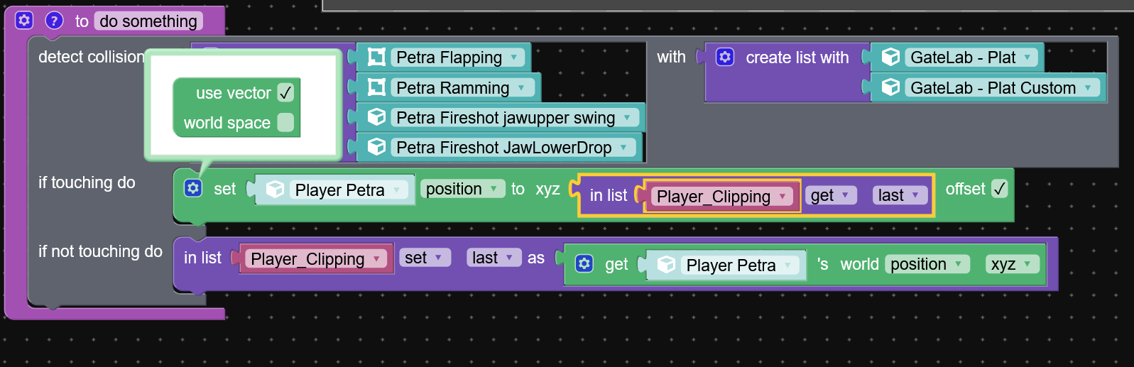

c4ccCustomer2023-11-14 at 2:50 am #68507bigmike814
Customerno, you need to change the setting to accept vectors. Just like you did on the get position puzzle.
2023-11-14 at 2:59 am #68509
c4ccCustomerI just did. Sadly, objects still going through each other
2023-11-14 at 2:30 pm #68547bigmike814
Customerare you looking at the console when you’re troubleshooting? I’m wondering if you set the variable to a list. If you can upload it to server and share the link I can check.
