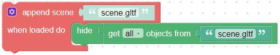

    Is there a way of preloading the next scene ( gltf file ) without
    showing it yet?
    When triggered it should load..Being there right away because its been
    preloaded before?
    Thanks
    Ger
    #54649
    Is there a way of preloading the next scene ( gltf file ) without showing it yet?
    you can hide it.

    #55323
    is it possible to make progressive scene loading possible
    I guess no for now. But you can load nearly empty scene quickly and then append several scenes one by one…
    Like this
    https://v3d.net/adf
