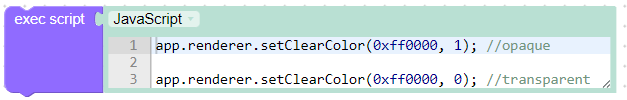

    And of course that is the effect I am trying to use… hm. I wonder if I can turn on a background while that effect is present. Mainly the problem is that I do not want it to be black.
    Let me explain, I turn the effect on at a certain moment in the animation and then off again later. I need the transparency but if I cannot have that while the after-image effect is happening, I’d like to specify what the background will be: a color or to show my environment texture.
    Maybe its as simple as applying an environment texture and then turning it off again when I want the transparency back?
    Does anyone know a way to toggle ‘transparent’ on and off??? (via puzzles or code?)
    #60350
    use this code
    #60352
    auriea
    That’s perfect!
    Thank you so much again, my friend.
