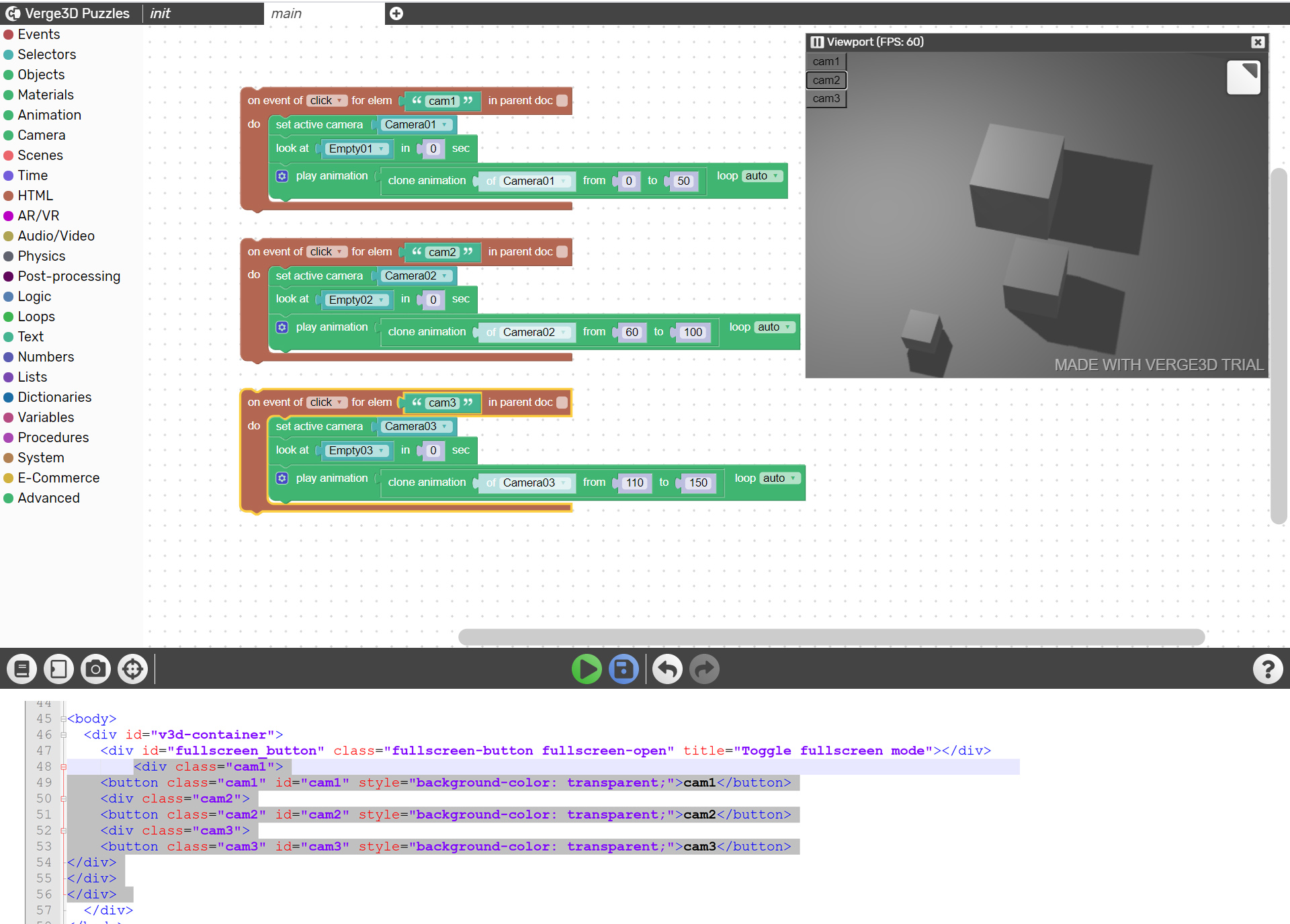

    #34266
    jaspixel
    Ok I think I cracked my first hurdle. It seems having my cameras in blender set to object properties/Animation/Loop mode set on “repeat” was the issue. I have now set all animated cameras to loop mode “once” and this works great. :good:
    Have attached screenshot of puzzle to help anyone else if stuck like me in the future.
    HTML screen at bottom to show div entry required in project html file to get the camera 1,2,3 html menu buttons too.
    Thanks again Yuri for clone animation tip :good:

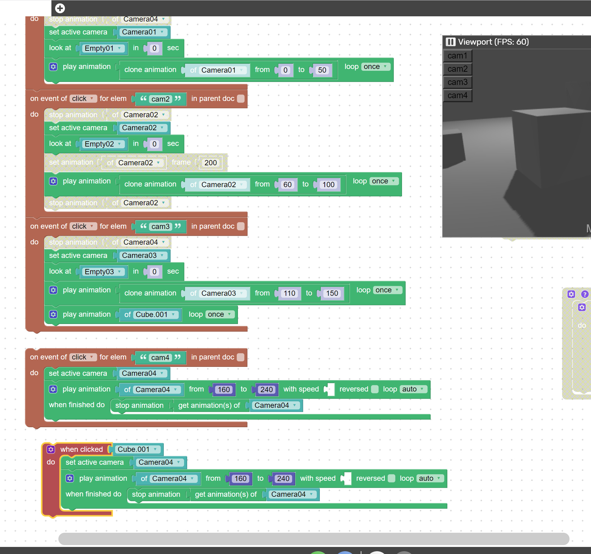

    jaspixel
    Hi Yuri,
    Some progress indeed, however I am wondering how to get around this issue.
    Please take a look at this explanation demo:
    https://cdn.soft8soft.com/AROAJSY2GOEHMOFUVPIOE:3e2fade9b1/applications/camera%20animated%20test/camera%20animated%20test.html
    I hoped I could just jump from one section of the blender timeline to another with corresponding cameras set (in blender) for each sequence on the timeline and then add menu buttons in verge to simply jump to each animated camera movements on the blender timeline using the clone animation puzzle as suggested.
    This test (link above) worked ok with the cameras that only had 2 key frames of movement. However as soon as I add more keyframes for new positions for the camera, the movements get skewed after the first run through during playback in the verge model.
    In this demo you can see cameras 1,2 and 3 are all as expected and if I click on the same button half way through the camera move, the view snaps back to the first keyframe position of that camera and plays out to the second key camera position.
    However, with camera 4. On first click it all appears to run through ok as the camera moves in a circle around the set. However, if I click the menu button for it again and interrupt the play to begin it again, the camera is now displaced and becomes increasingly so as the animation plays out.
    What am I doing wrong please? Screen shot below and blender file attached.
    Also, if I set certain animation sequences to happen at different times on the timeline, is it not possible to only have those animations occur if I tell that part of the timeline to play, otherwise I want the animations to remain static? Does the blender timeline always play from start to finish regardless or can I control this more please?
    Many thanks Yuri. I am an imminent Licensee I promise, this is a great tool :good:
    best,
    Jas
    #34287
    Seems like you using orbit camera with animation, you need to set no-controls for all cameras with animation on it. If you need camera for free scene observe, better to create another one camera with orbit controls, but without an animation on it.
    #34306
    jaspixel
    Hi Mikhail,
    Ok thanks, I just tried that.
    However, with controls off I had to add a constraint to the camera to track to the empty in the middle as it rotates around the scene, but on repeated clicks of the cam 4 button, the camera still continues to move closer and closer to the empty it is tracking and never resets to keyframe 1 position. But cameras 1,2 and 3 do not no matter how many times I click their buttons, they always jump to first camera keyframe position? Odd that adding more than 2 keyframes to cameras messes this all up!
    Why is the repeated click of the html button (cam4) making the camera jump closer to the tracked empty every time please?
    Updated version here:
    Many thanks,
    Jas

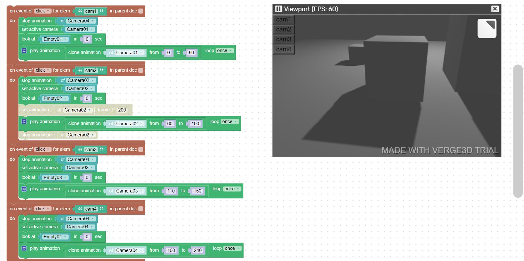

    #34318
    jaspixel
    Aha, ok I think I worked it out with this puzzle fixed combo.
    The camera doesn’t jump forward anymore when I click on the html button or the cube, which I also set to play the same camera move.
    Onto setting each animation sequence to play with each camera now :) :good:
