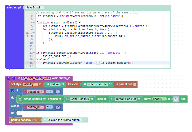

The artist popup (div id= artist_main_list) is opened/unhidden by clicking on the topleft corner icon on the main page.
This popup contains a div (id= framelist) with a iframe containing artist_names.hmtlNow within the html names page, when a button is clicked, the click action should hide/close the popup (artist_main_list), and tween to the camera position set in the puzzle.
See the attached screendump for the puzzle, all other code is in the puzzle as well.
If we can get the button click in the iframe html page to register, we can then add it into the rest of the puzzle logic.I hope this makes any sense ;)

Ivan LyubovnikovStaffHi, I made some changes to the project you shared: https://www.dropbox.com/s/4s1o95mas7vm8uq/ASK_Gallerie3.zip?dl=0
– now the buttons can trigger a procedure defined in puzzles where you can manipulate the scene camera.I added the “id” attribute (and set it to “artist_names”) to the corresponding iframe in the “index.html” file so it will be easier to access it from puzzles. I also added the following puzzles to handle clicking on the artist buttons:
– the “on_artist_button_click” procedure is called whenever you click the button and the “button_id” parameter can be used to distinguish which button was clicked.
Hope this helps!Attachments:
