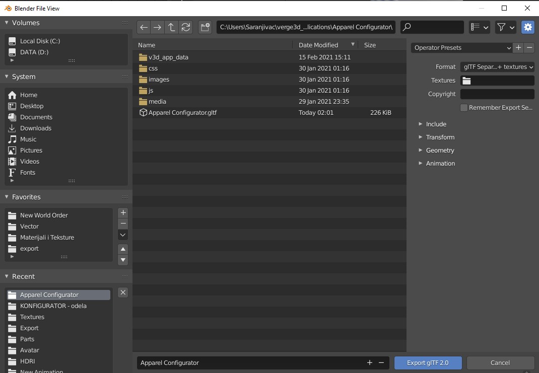

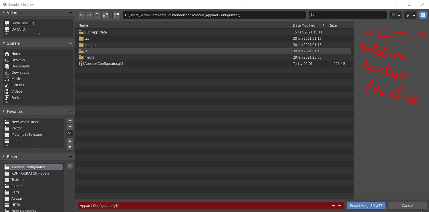

saranjivacCustomerSince I am now running into the same issue, here is a suggestion for some future version of Verge3D.
Perhaps on the export screen add a “texture folder” field with a path relative to the .gltf
That way the user can pick the same folder for multiple .gltf files and thus use the same textures without the need to do anything in puzzles.
Something like standard .gltf 2.0 export addon has.
