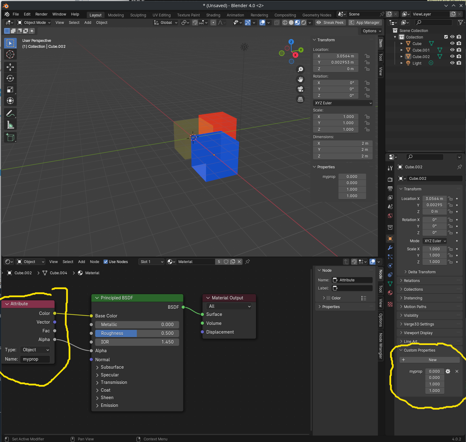

kgmoney
ParticipantHi,
In Blender, I can use custom properties as drivers in a material so that I can have one material shared by many objects and yet tweak the material on each of those objects (each one can have a different color for example). This is really handy, but I understand that Verge3D doesn’t support blender drivers.
What would be a way to accomplish the same thing in Verge3D. I’d like to have only one material to manage, but I want each of my objects that use that material to have their own color and transparency. Also, I’m using Javascript, not puzzles.

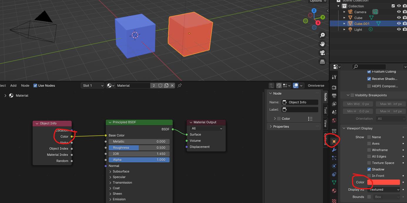

Tutorials - https://www.xeons3dlab.com2023-12-08 at 11:11 am #69041Mariusz
CustomerYou can also use the Object Info node and its Color slot. Then you can set up the individual colors per each object in the Object Properties tab -> Viewport Display -> Color.
2023-12-08 at 4:28 pm #69048kgmoney
ParticipantThanks @Mariusz….I’ll give it a try….any tip on what properties I need to manipulate via my javascript to change the Viewport Display Color in Verge3d?
2023-12-08 at 4:33 pm #69049kgmoney
Participant@kdv
Sorry, misspoke…I did try drivers, but was I meant to say was custom properties with an “attribute input” node. Here’s my setup in blender….all three cubes use the same material, but have different values in the “myprop” custom property.
2023-12-08 at 5:34 pm #69052kgmoney
Participant@Mariusz
Looks like I have your solution working….from javascript, I can change [object ref].objectAlpha and [object ref].objectColor to achieve my goal. Thanks!
2023-12-08 at 7:20 pm #69054kdv
ParticipantYeap, the
Object infonode is exactly what you need. You can adjust color/alpha both in Blender and Verge3D (via scripting)Puzzles and JS coding. Fast and expensive.
