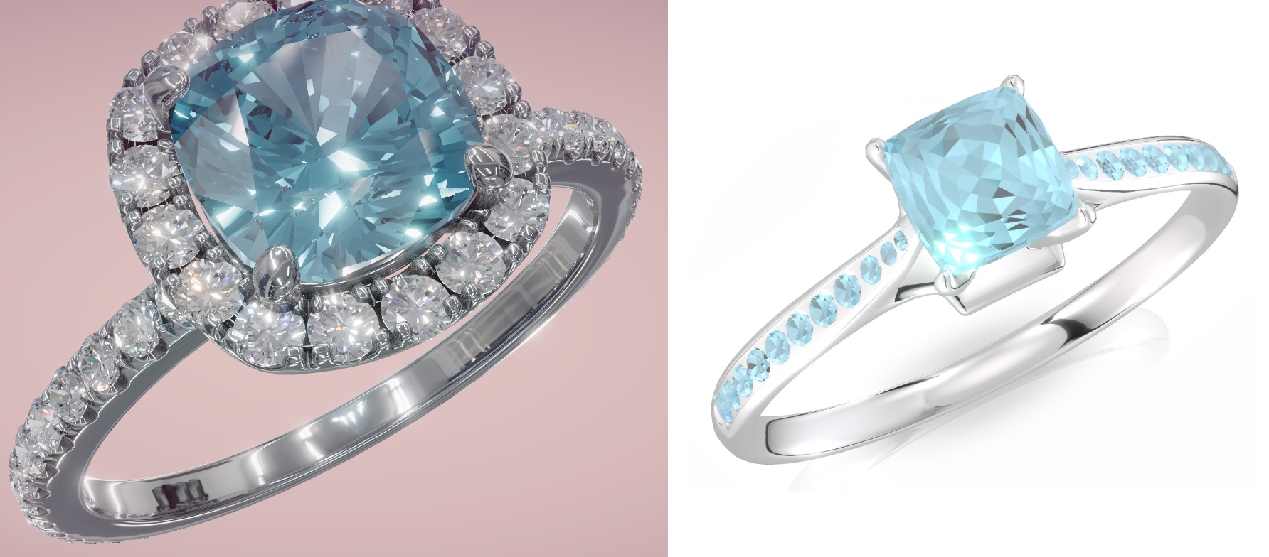

    What do you see as the quality difference? Is it the reflection maps, lighting, the bloom, the modeling?
    From what I see the three js version has a higher mesh density gem, higher bloom setting, different lighting and a different reflection map. Other than that… I would think you could get these same results in V3D.

    The main difference is the caustics effect. In r3f, this is a basic component, whereas in Verge3D, there are fewer advanced features available, and it requires custom development.

    Brameister
    Basically everything. I see a much sharper image, like it is being rendered in Cycles. The bloom is much more balanced, there also seems to be an autofocus and depth of field feature of some kind, reflections are so much better.
    You guys really don’t see a huge difference? Here’s a side-by-side
