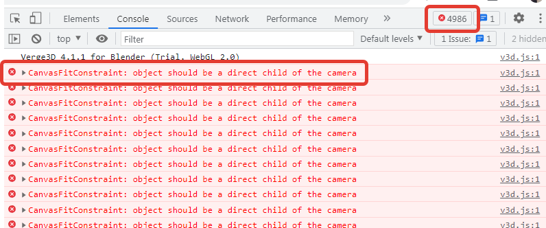

Thankyou.2023-03-17 at 11:37 am #61133kdv
Participantthere is one repeating error
2023-03-17 at 12:07 pm #61137
albiParticipantReply to kdv;
Hii thanks for pointing this out.
Why is this happening? Will it affect the performance of my app anyway?
And any idea how to solve this error?2023-03-17 at 12:20 pm #61138
Yuri KovelenovStaff2023-03-17 at 12:23 pm #61139
Yuri KovelenovStaff2023-03-17 at 4:42 pm #61141kdv
ParticipantRemove constraints from the object “AR button”. Verge3D add-on exports parented objects with an intermediate node named “v3d_proxy_node…”. So this button is not a direct child of its initial parent and
CanvasFitConstraintis not working.if (obj.parent !== camera) { console.error('CanvasFitConstraint: object should be a direct child of the camera'); return; }It won’t affect the perfomance much. Just a harmless error writing to the console log every frame )))
