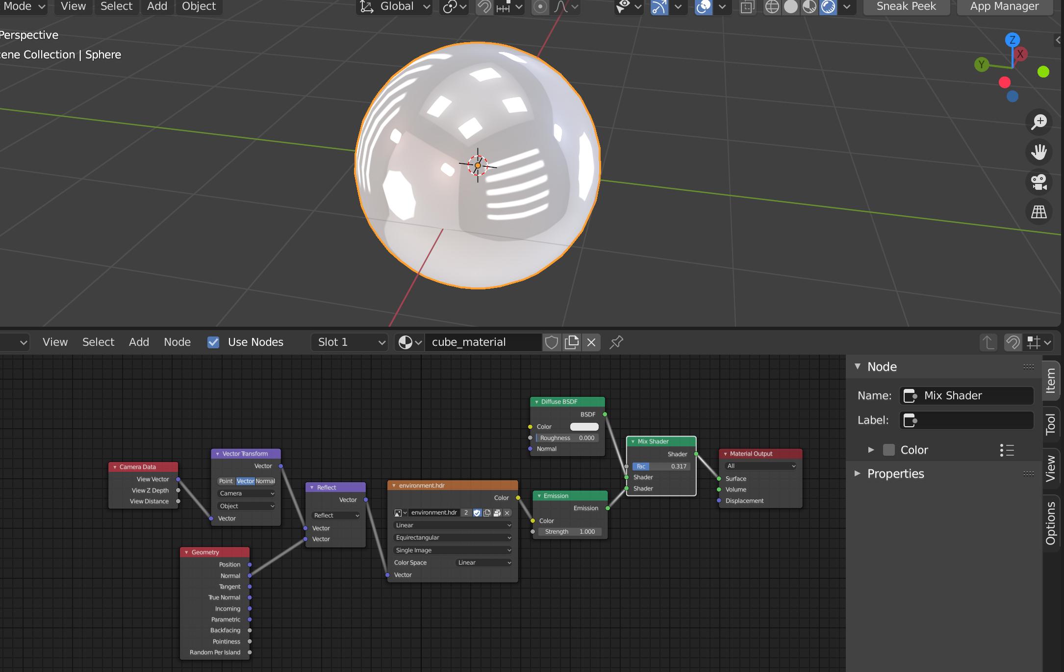

    Not yet, though you can simulate such behavior with Vector Transform and Reflect nodes:

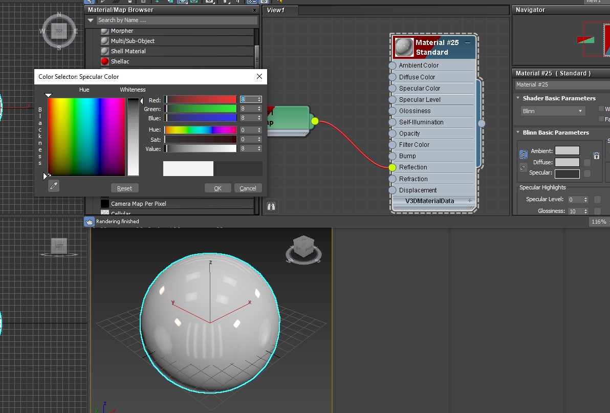

    Sorry to ask, but when i put my hdr picture in the reflection slot of the standard material, it goes chrome even with the percentage of map donw to 10 instead of default 100)…
    Please see my screenshot (sorry it is small for balls).
    The red one is nice shader, but reflects the default hdr environment : i can’t change it as it was made for the special glass billards table to get nice reflections.
    the chromed ball is with standard material, and another hdr envir in it’s reflection slot : see, even at 20% it goes chromed.
    Any help ?
    #29200
    You need to change specular color to change environment influence. You can connect a fresnel node to it to add a fresnel effect on the material or any map etc

    Ok, it is better, no more chrome, but as you can see in my screenshot, the “standard”-shaded ball it black (with wanted reflects on, thanks).
    So i guess standard materials are not lit with environment HDRi lighting, like the physical-shaded is.
    #29207
    Yes, it’s can be lit only with light sources.
