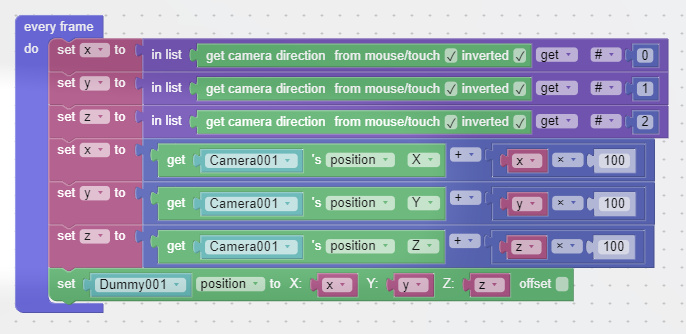

Yuri KovelenovStaffHello again,
Thanks to recent developments, it is now possible to make an object look at the mouse cursor:
In 3ds Max, the cube follows a dummy object by utilizing Rotation Controllers / LookAt Constraint (in Blender, this corresponds to TrackTo constraint).
In Verge3D 2.11pre2, it is possible to map the position of the dummy to mouse cursor with the get camera direction puzzle and some simple math.
Source project attached.
2021-01-24 at 10:41 am #37663ohrha
ParticipantGood Evening! Would you mind going over this process for verge3d 3.4+, unless nothing has changed.. I can’t seem to find the last numbers piece that i need in the camera puzzle. I’m wondering if it has been removed?
What is the new process for getting the camera to follow the mouse?
Thanks alot.
