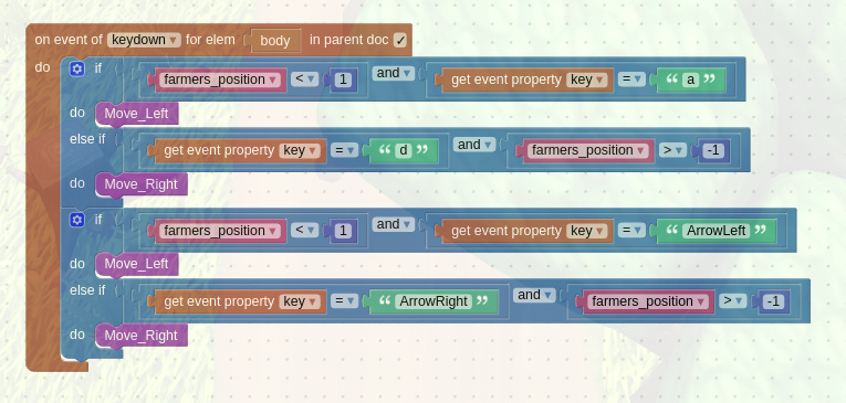

Yuri KovelenovStaffHi,
This is interesting question, because our Farmer’s Journey game also works inside an iframe, is keyboard controlled yet it does not manifest any issues like that, for example, after clicking the fullscreen button and returning from fullscreen mode.
We use the following puzzles setup for keyboard controls:
Can you try to compare your setup with ours and find out if there is any difference?Attachments:
