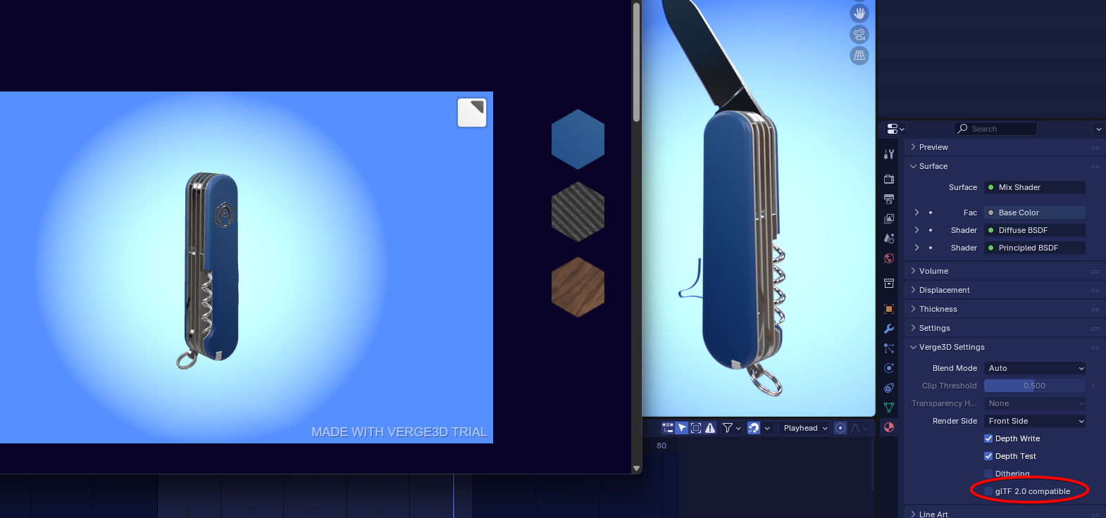

    Im using Blender 4.5 LTS with Verge3d 4.10 but this has been happening to me for a couple of previous blender versions as well. I might just be dumb, but when i use any materials on any objects, the model does not show any more in the verge3d scene. I can remove the materials entirely and it shows again. I made sure all the shader nodes are correct and its literally just the basic bsdf to material output.

    I found out the issue. I had to enable gltf 2.0 compatible under the material verge3d settings.
