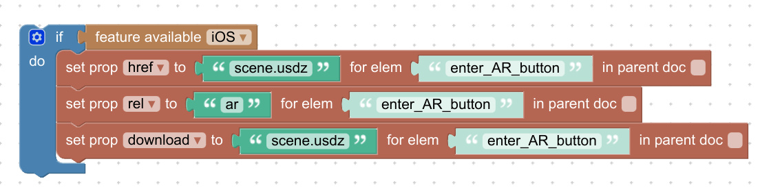

    on iOS, WebXR is still unavailable, so at the moment, AR content can only be rendered using Apple’s USDZ viewer. Unfortunately, Verge3D (as well as Three.js which it is based on) does not support animation for USDZ models yet.
    As a workaround, you might create USDZ scenes using your 3D modeling suite and load them directly. You can do it by providing the path to the .usdz file in the AR puzzles group.
    USDZ AR on iOS

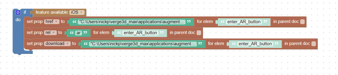

    Many thanks for the reply. I have tried linking to the .usdz file directly (I am assuming the file needs to be in the same directory as the project) but on ios it says ‘object could not be opened’. I am using the AR template so is there something else I need to do to it such as deleting any existing objects in the max scene or removing references to objects in the puzzles?
    I have attached a screen shot of how I referenced the .usdz file.

    it is important that you copy the .usdz file into the app folder, so that you can use relative path to it. Right now it uses absolute path to the file.
    #52087
    nickparsons
    It is already in the app folder so I just need to use the file name as opposed to the full path right?
    #52089
    yes, something like your_file_name.usdz
