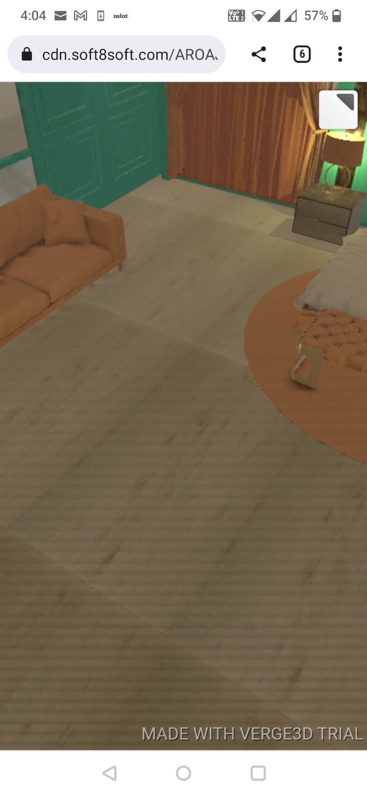

    Im very new to Verge3D and have been evaluating it using the trial version since 2 weeks.
    I find multiple parallel lines on all surfaces which change with camera view. This happens only in mobile version and not in desktop. I am attaching a screen shot and also the URL to the project file.
    Project URL : https://v3d.net/d23
    Can someone please let me know the reason for this ?

    Adreno renders without lines. There were some problems with Mali video chips in WebGL apps…

    Adreno is a video chip, Mali is a video chip, PowerVR is a video chip. Different phones have different graphics systems.

    thank you. is there a workaround while creating the model itself? Or is this something everyone lives with?

    I just tested using firefox on the same phone and it works.. tried on an iphone safari browser and it works fine too. Issue is with chrome browser on my phone. Is there a way arround this?

    are you using dynamic shadows? If so, you can simply disable shadows on mobile as a workaround:
    https://www.soft8soft.com/docs/manual/en/puzzles/System.html#feature_available
    and
    https://www.soft8soft.com/docs/manual/en/puzzles/Camera.html#set_light_param
    If you definitely need shadows on mobile, you can try these recommendations: https://www.soft8soft.com/docs/manual/en/max/Shadows.html#troubleshooting

    Yes i was using shadows. i believe i can disable them without much loss in quality. Il try this today.
    Thank you.
