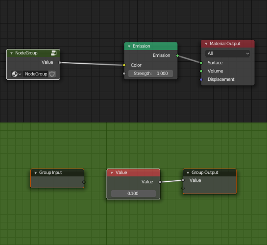

Ivan LyubovnikovStaffHi GlifTek,
Actually, right now there’s a bug with node groups which can happen for some node setups.For example, it won’t work if you link a Value node directly to the group output:

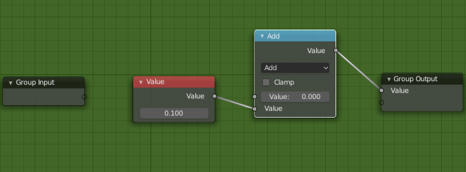

As a workaround you can link it to some other node (e.g. Math/Add with zero value) and then to the output:

GLiFTeKCustomerHaha!
I HAD that! /facepalm/
I had taken it out to “simplify” unneeded nodes.
Thanks!!Visit the GLIFTEK Verge3D Plugins Store!

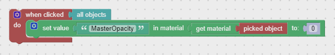

(If someone could take a look at it, that would be fantastic!)An invisible cube “Cube.Master_Opacity_Control” holds the material “Cube.Master_Opacity_Control_Material” which has the “Master_Opacity_Group” group in it that’s used to control the opacity of the 3 visible cubes, each with their own materials.
The Value in the node group to be changed is “MasterOpacity”.I have the puzzles set to have the “MasterOpacity” value change to 0 when anything is clicked, which does not happen.

Ivan LyubovnikovStaffI have the puzzles set to have the “MasterOpacity” value change to 0 when anything is clicked, which does not happen.
The puzzle “set value in material” doesn’t work like that because, despite sharing the same node group in Blender and reacting to the changes at once, these materials are handled separately in the engine. You need to specify a particular material, e.g. “cube_material.001”, “cube_material.002”, etc… to make changes to them.
So, for now it requires to list all objects or materials which you want to apply changes for, for example via the “create list with” and the “for each item in list” puzzles.
Also, in the test project you can change the puzzle setup to the following to make it work:
