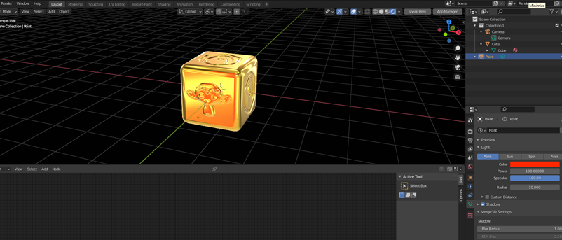

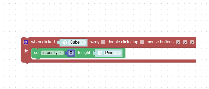

    Hi, I cannot understand why I cant turn a light on / off. The following puzzle should in my mind work, it does not. This is the cube example that comes out of the box and I just added a point light. I made the power and specular 100 and when I click the cube, no change. Please advise.

    May be light has less influence of the scene, because on default scene main lighting made with environment. Try to disable environment and leave only point light, so the cube will absolutely dark without that point light.

    ocularvr
    Thanks for the reply.
    Its working now, I increased the radius – I noticed that things light emissiveness of a texture or the light radius need to be multiplied when viewed in verge.
    Again, thanks for your help and patience.

    matthijsbinmat
    I am using that exact setup with succes! :good:
