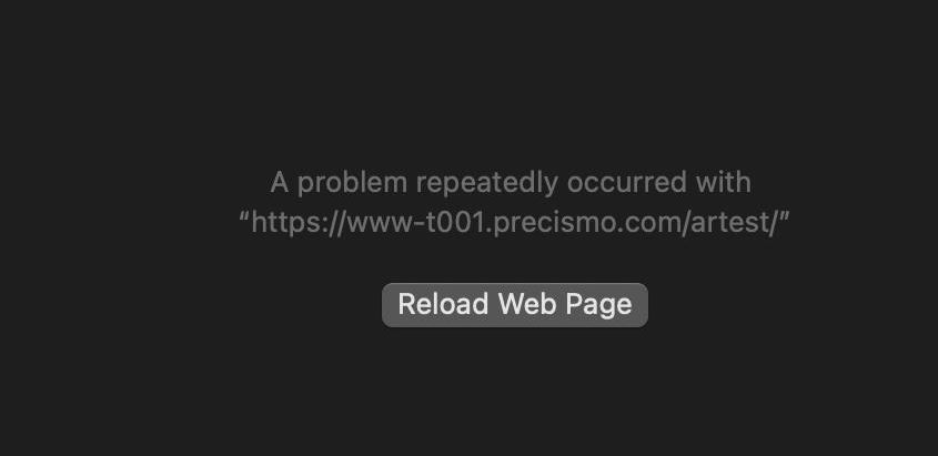

precismoCustomerHi,
after latest upgrade our iPhones and iMac devices, Verge3D scenes stopped working in Safari and mostly in Chrome as well. It is general for all Verge versions and not url/server specific. Sample test scene published on our server:
https://www-t001.precismo.com/artest/
Browser is getting only “there was an error on this page”. No console output, nothing more specific as attached.
Windows PCs and Android devices are running without any issues.
May I ask how to solve this?
thank you very much in advance,
Petr from Precismo

Yuri KovelenovStaffGot it. It is the xrCompatible flag that we use for initializing WebGL context (to allow for WebXR). It appears Apple added WebXR to Safari 15 but it is too buggy. Normally, the browser should just ignore unsupported flags. Will file a bug report to Apple and fix this in the upcoming Verge3D 3.8 (which is expected tomorrow).
UPD Submitted issue.

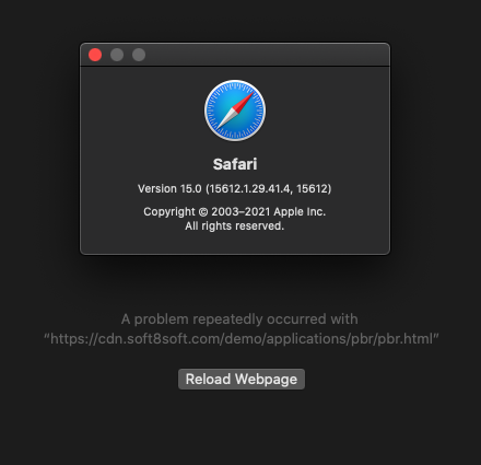

mOnzCustomerYes i have same problem too..
After updated Safari to Version 15.0, they won’t open.

The problem is that Verge3D can’t be opened in the new version of Safari (version 15.0) Mac OS X.
I have tried as i say above..Have you tried in (Safari 15.0) Mac OS X?
But yes, i agree to change the title.. if verge3d only not work in safari mac os x version, not in iOS version 15.0, because i’m not tested yet in ios 15..
