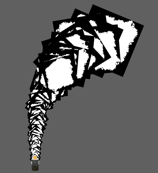

2023-08-08 at 1:14 am #65868kdv
ParticipantIt depends on textures used. Your texture initially looks like a flat piece of wood.
In that demo smoke particles are also just planes always facing the scene’s camera.
2023-08-08 at 2:42 am #65870
c4ccCustomerTrue. So if those planes/textures are side by side, on the x or y axis, how do I make them always face the scene’s camera without them tilting? Like if we used multiple fire/smoke drums in your scene side by side, the fire and smoke always face the scene’s camera

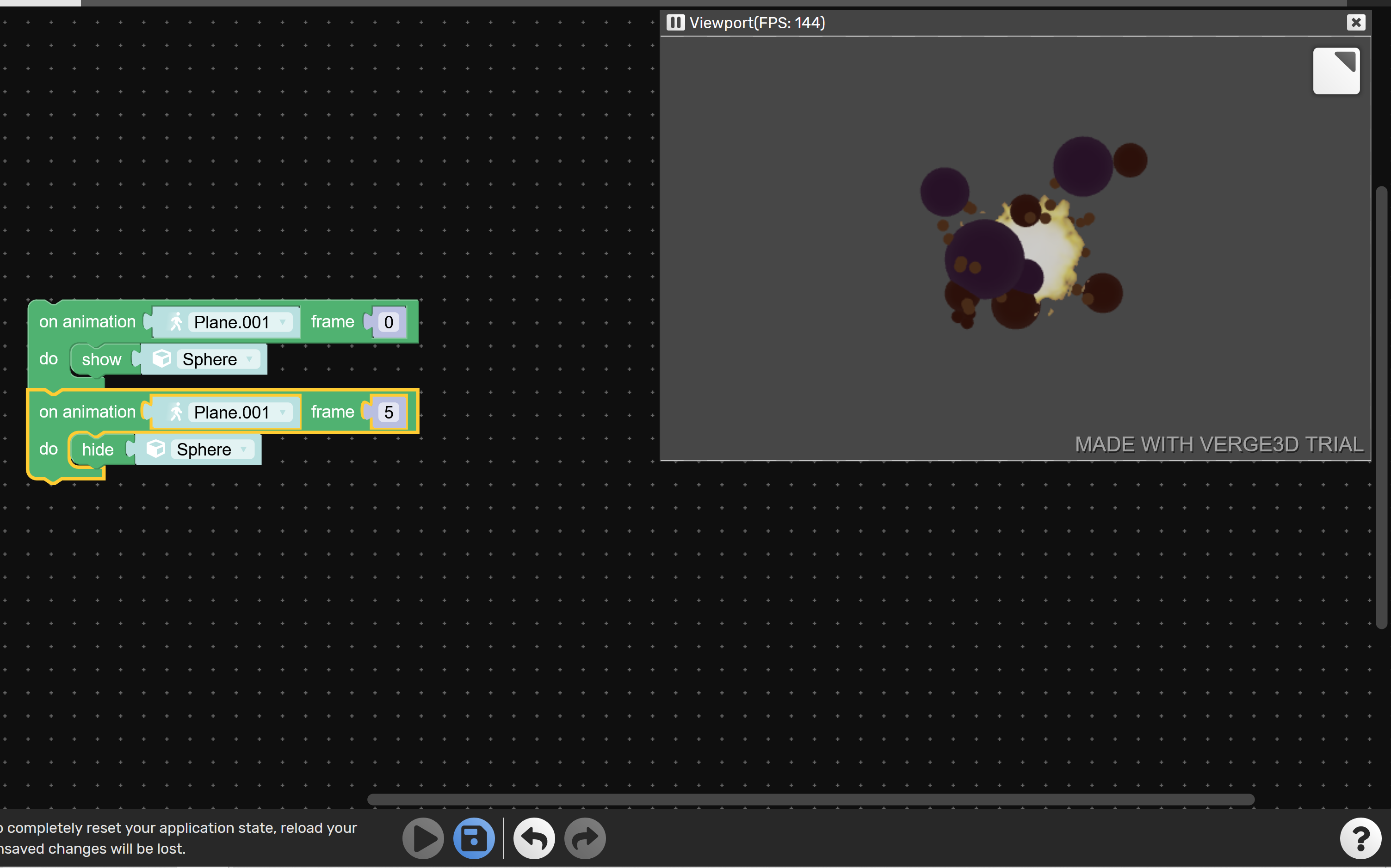

c4ccCustomerI did assign the “show” and “hide” to Sphere, under the explosion’s animator. Unfortunately, the Sphere did not appear and disappear as per the frame.
2023-08-08 at 7:07 pm #65900kdv
ParticipantI see at least two mistakes in your animation and puzzles.
1) your animation starts with 1st frame and never plays 0th frame (in puzzles you use 0th frame).
2) your animation is supposed to have 10 frames but you didn’t add 10th key frame. Frames 6…10 are never played in your animation. That’s why it’s played twice faster than in Blender: it’s twice shorter, only 5 frames.On my side it’s working as expected
https://v3d.net/mp0P.S. The first and the last frames shouldn’t be used in the “on animation frame” puzzle. Intermediate frames only.

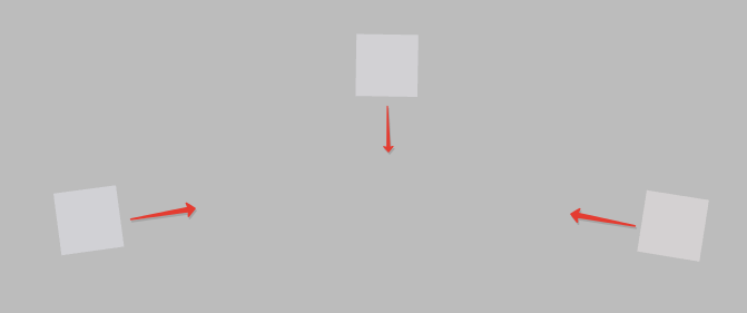

2023-08-11 at 1:10 am #65981kdv
ParticipantDo you mean this side-effect of “TrackTo”?
