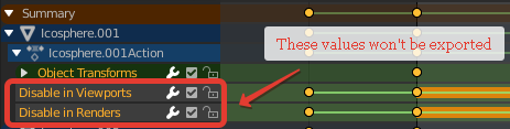

    To make an explosion, under visibility, I tried to use keyframes to turn on and off visibility for viewport and renders as shown here.
    While it worked in Blender viewport, only one object seems to appear and disappear when I viewed the scene via sneak peak. How do get the Blender viewport scene to appear as it did under sneak peak in the browser as well?
    #65770

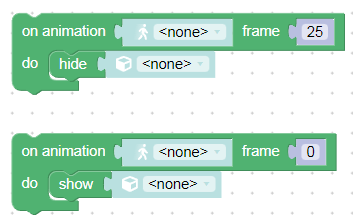

    In Sneak Peek? No way. Only “Object Transforms” values will be exported.
    But you can do it via puzzles in your app

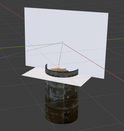

    Use textures on planes with TrackTo constraints (to face the scene camera). Forget about emission and complicated procedural or modified geometry. THREE.js is not Blender.
    #65780
    c4cc

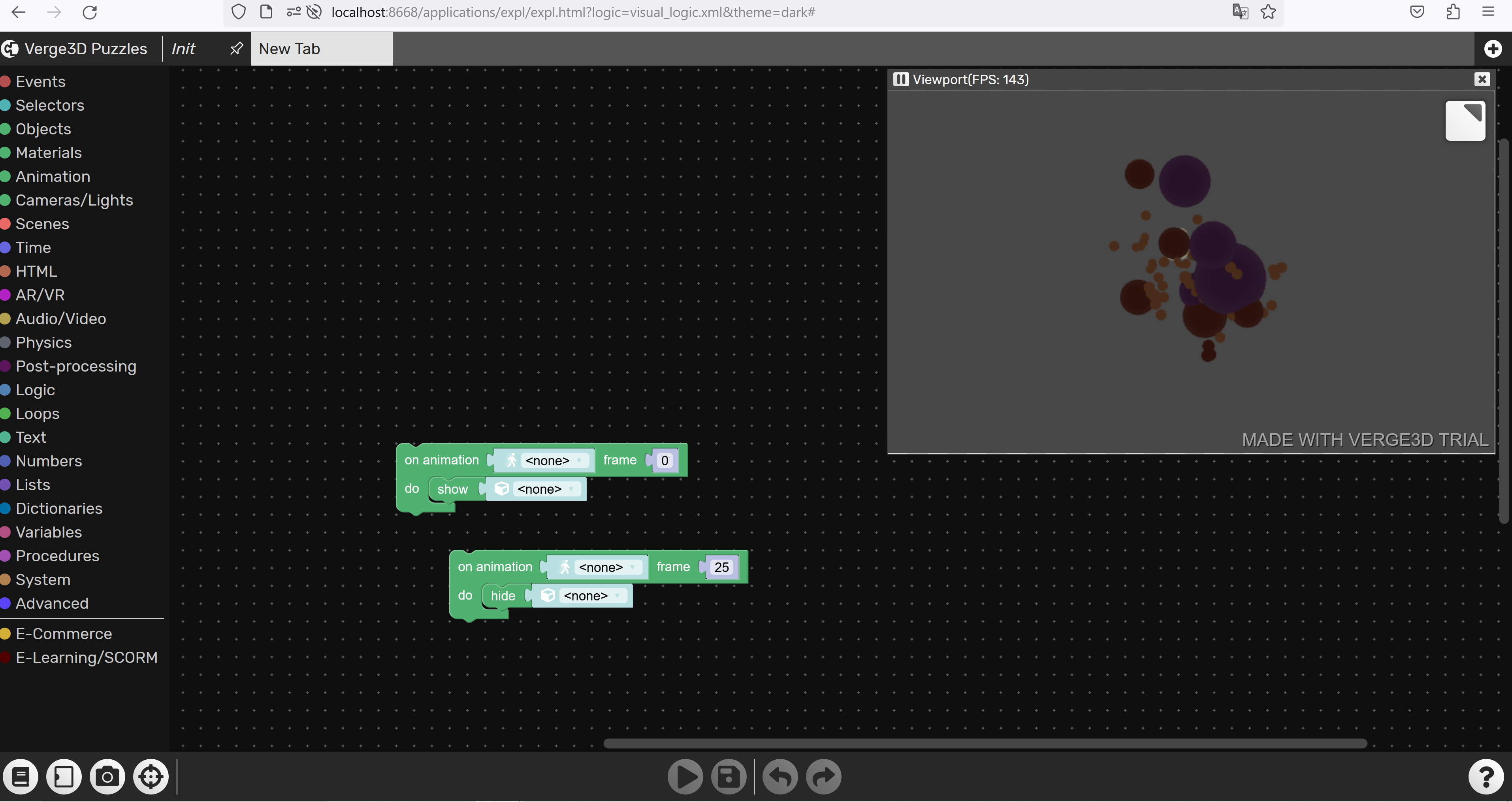

    I tried this, but sadly ended up with this.
    #65783
    Really? :wacko: You should choose some animation to read frames, you should define triggering frames, you should choose objects to hide/show. Think!!!

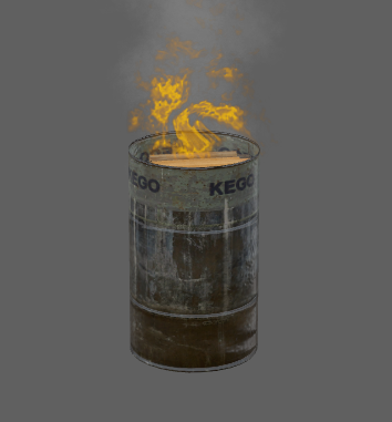

    What you really need to know and learn is how to create fake effects. And puzzles.
    Blender (just three planes to simulate fire) => Verge3D
    https://v3d.net/mm3

    #65792
    It’s “TrackTo” constraint. You can apply it in Blender. No puzzles were used to simulate fire.
