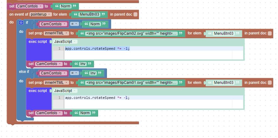

    thanks for your replies. I was mostly able to get it to work. I was able to invert the rotate controls, and also lock the pan tool on one project… but on another I have yet to be able to get the pan controls to be tied to left click (or touch & drag on mobile).
    I have attached a screenshot of the modified code. I actually had to change “app.controls.mouseButtons.PAN = v3d.MOUSE.LEFT” to “”app.controls.mouseButtons.PAN = v3d.MOUSE.RIGHT” otherwise I was unable to pan at all. With this code, however, I have to use the right click to pan, and I am unable to pan on mobile.
