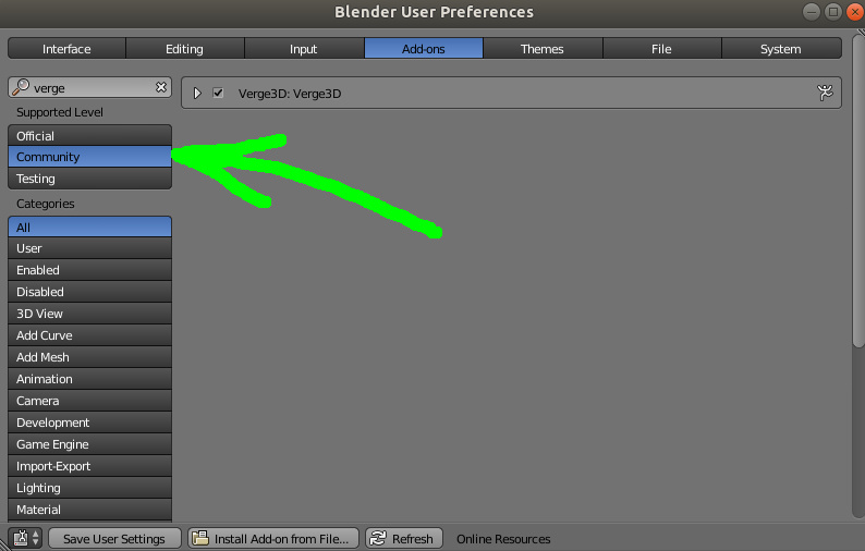

Yuri KovelenovStaffCan you please check if the Community category is enabled? Because if not the Verge3D add-on will be filtered off.
2018-12-04 at 2:41 pm #9518Clemens
ParticipantWas already enabled.
2018-12-04 at 2:44 pm #9520

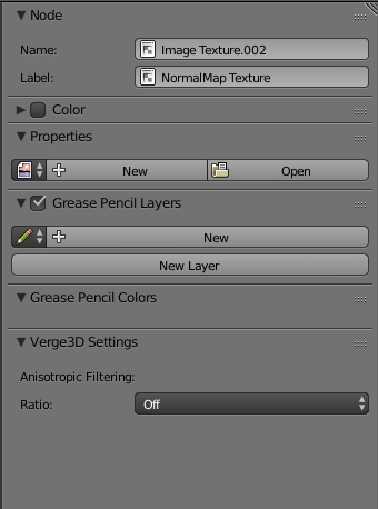

Also, I think there is a typo in the NormalMap texture node in the stock Verge3D PBR material……in the attached screenshot. Or is it called NormapMap???

https://www.soft8soft.com/docs/manual/en/introduction/Material-System-Blender.htmlAlso, I think there is a typo in the NormalMap texture node in the stock Verge3D PBR material……in the attached screenshot. Or is it called NormapMap???
Good catch! We’ll fix this typo. You can also change the texture name yourself in its settings.
