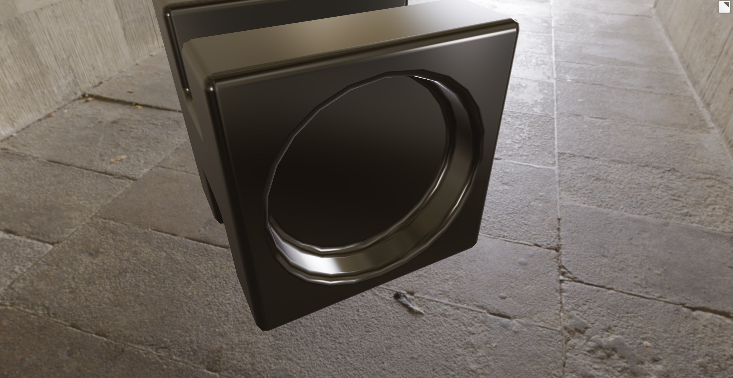

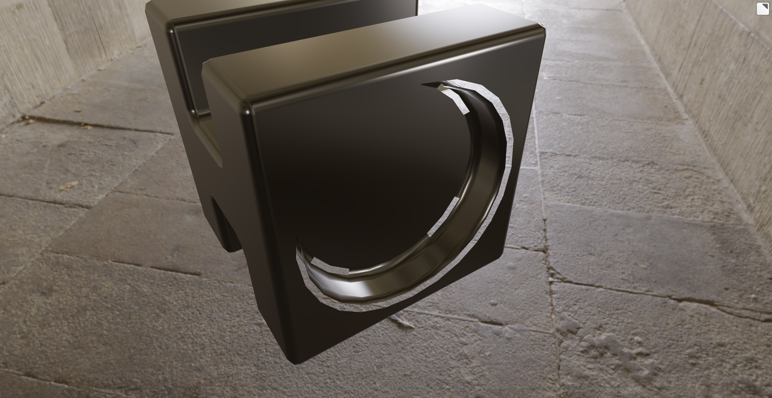

    we have noticed this strange error for some objects. We were working on tiny parts of watches and for some reason some vertexes keep disappearing in Verge viewer after export (from Blender). We were able to create minimal error sample.
    Im attaching error and “ok” sample – difference is bevel radius.
    Please can you help me identify reason and fix?

    a likely reason is that the modifier flips the normals of your model.
    3D Verger, the CEO
    #37635
    It’s all ok with normal, but seems it’s a bug because of the very small size of the objet and not applied scale. We will fix it in some of the nex releasesm but for now you can apply scale and increase size of the object a little bit.
