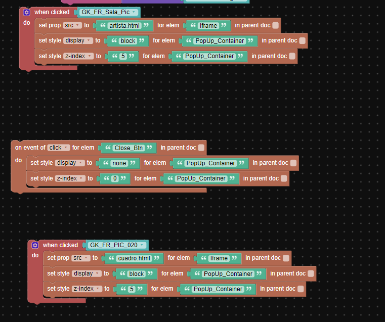

CustomerI am making a tour that when I click on an 3d elements opens up an iframe,
the problem is that when I try to close it with the close button div that is outside the Iframe the v3d scenes rotates as if the click is still moving the camera, it appears that it doesn´t log the end of the click until I click out of the Iframe element.
Is there a way to solve this? by the way I am using first person camera.
thanks in advance!!Attachments:

CustomerHello!,
Sorry for the delay, here is a simple project that reproduces this problem:http://www.360.r2-a.com/3D/index.html
Also I have 2 other problems if you can guide me where to look for an answer:
1. I am trying to change the texture of an element to a youtube video and it does not work, I´ve already looked for an answer in the forums and can´t seem to find one and checked the puzzles too.
2. I want to make the first person movement responsive to mobile devices but I can only walk with WASD keys so I don´t know how to solve it.
I know these questions might be a little dumb but I´m not a programmer to be honest.
Thank you for reading me and I hope you have a solution for this!
