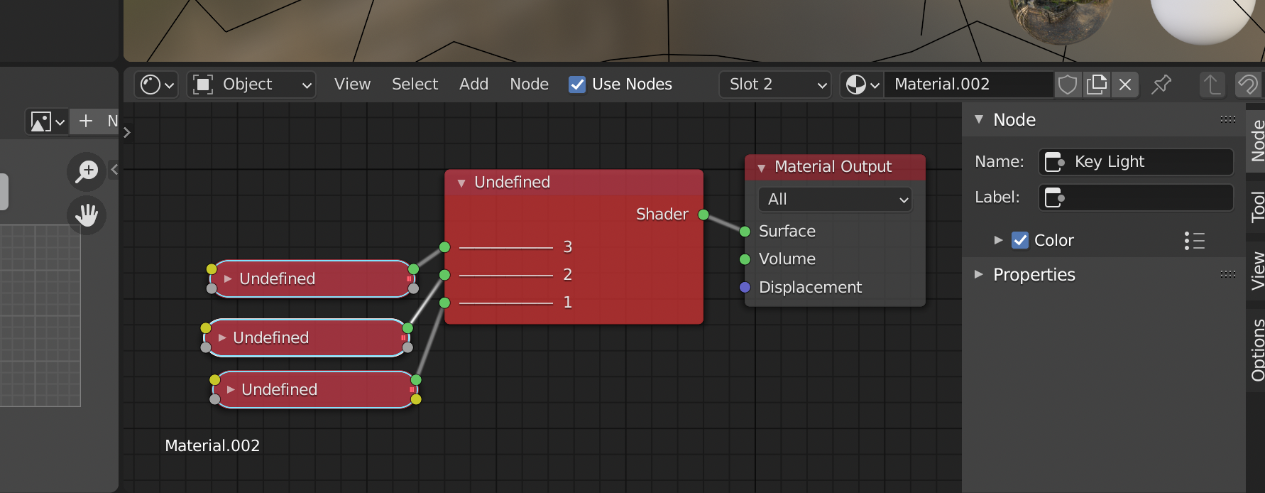

    I bought “Lightning Boy Shader”.
    https://lightningboystudio.gumroad.com/l/aYbiH
    I expected it wouldn’t work because it’s a shader for Blender.
    Sure enough, I get a shader error in my browser.
    If anyone knows how to fix it, please let me know.
    The following files have the add-ons turned off, but the shaders work on Blender.
    https://www.dropbox.com/s/fooxiullex0079b/shader.blend?dl=0

    #43300
    It looks like this add-on creates custom shader nodes which are not supported in Verge3D.

    #43373
    If there is a Toon Shader that can be used instead, I would appreciate it if you could let me know.
    Any materials that uses standard Blender shaders without additional scripts.
