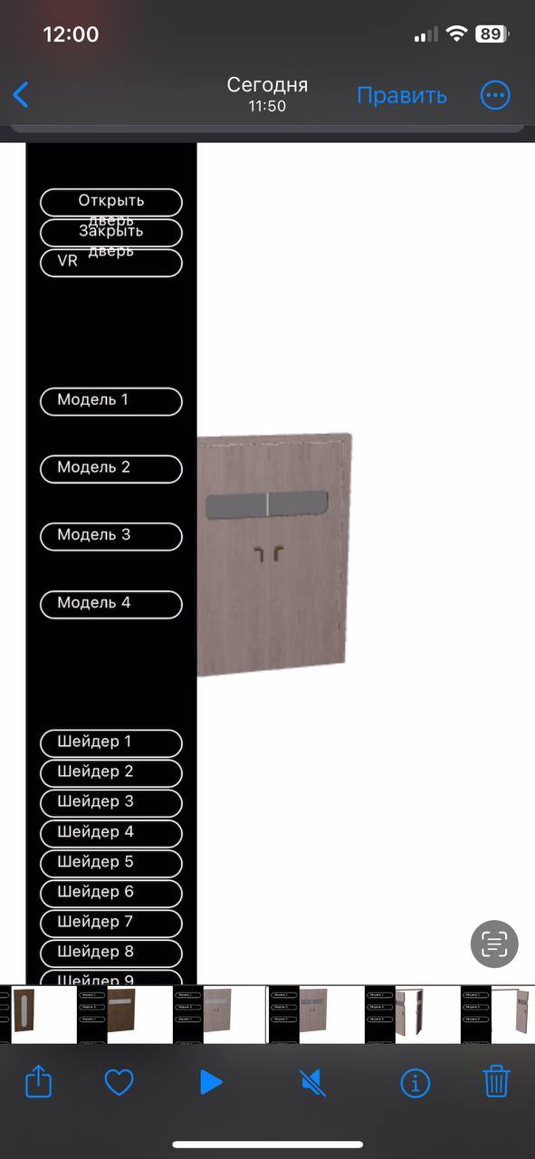

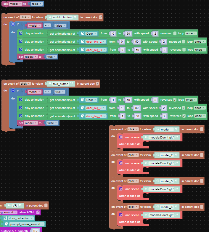

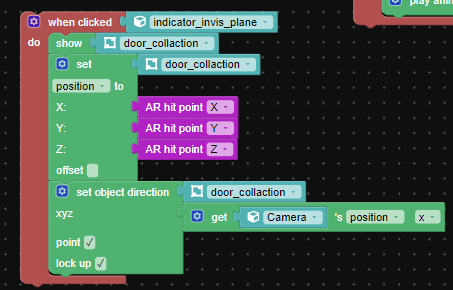

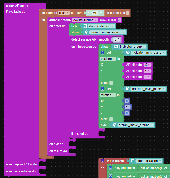

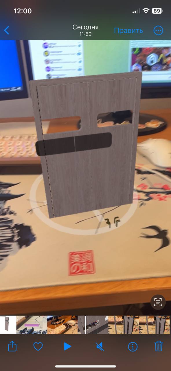

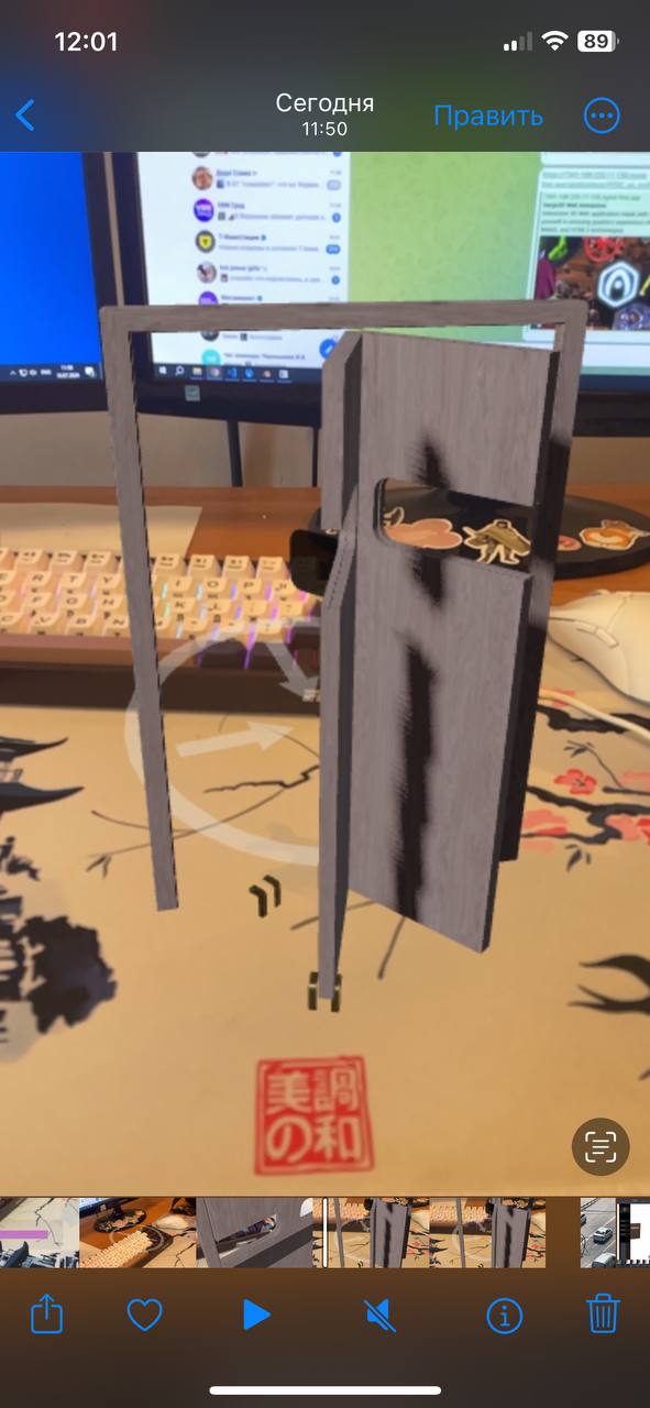

    Good time of day. Help anyone who can. I have attached the photos below. Initially, I did not understand the model in its usual form, but after downloading augmented reality, the model breaks down, and the elements of the model are not in their places. I use the iPhone 12 to open augmented reality.

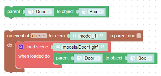

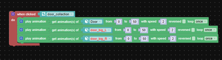

    надо смотреть, чего ты там в паззлах накодил. лучше упакуй приложение, залей куда нить и выложи ссылку. так будет гораздо проще выяснить, что пошло не так.
    #75825
    bigbea1r
    Thanks for the reply. Here is the link
    https://v3d.net/112b
    link to the project
    There is also such a link
    https://disk.yandex.kz/d/Dco5BlIpGu3Tmw
    • This reply was modified 7 months ago by bigbea1r.
    #75835
    https://v3d.net/112d

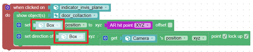

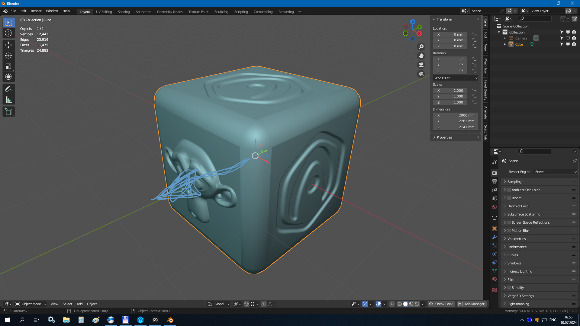

    Thank you very much for your help. Or you can tell me the last one. Why is the door facing me sideways? Thank you in advance
    #75839
    Because that is the direction for your “Box”. Change its direction in Blender. The direction in Verge3D for any object is a vector along its local -Y axis in Blender.
    #75841
    bigbea1r
    Oh, thank you so much. You’ve been very helpful. Have a nice day, have a nice day
