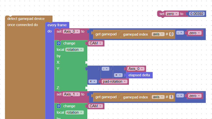

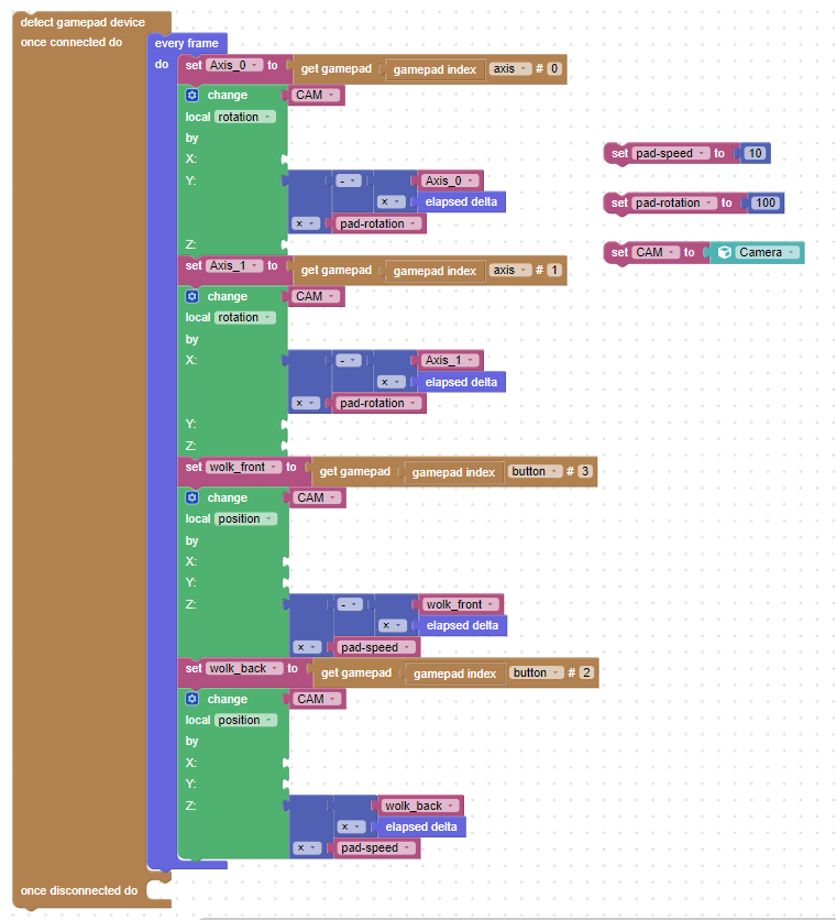

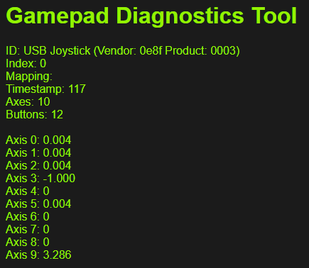

cralex75Customerhello, I’m experimenting with gamepad puzzles to use a first person camera, also using the “collision material”, it works, but I have a problem, if I use the normal puzzle the movements are very slow, if I apply a variable to define the speed inserts an abnormal movement to the “oscillation” camera. The problem is the “0.004” position of the gamepad, if I assign the speed variable to 100 that value is amplified to “0.4”
How can i solve? Maybe something is missing?2023-04-14 at 8:42 am #62059
Alexander KovelenovStaffThe problem is the “0.004” position of the gamepad,
Hi! You mean this value reported by the gamepad when the sticks are at the center? Perhaps you need to add basic logic puzzles to disable the movement, when stick axis value is lower than some minor value, say less than 0.005.
2023-04-14 at 3:22 pm #62078
cralex75CustomerI looked in the forum but I didn’t find any topic about it, for now I set a negative value equal to the drift value, to avoid the displacement.
This can’t be a definitive solution, because joypads are not all the same, you should set the “deadzone” value at least to 0.005 or higher.
Can anyone help me to solve this problem.Attachments:
