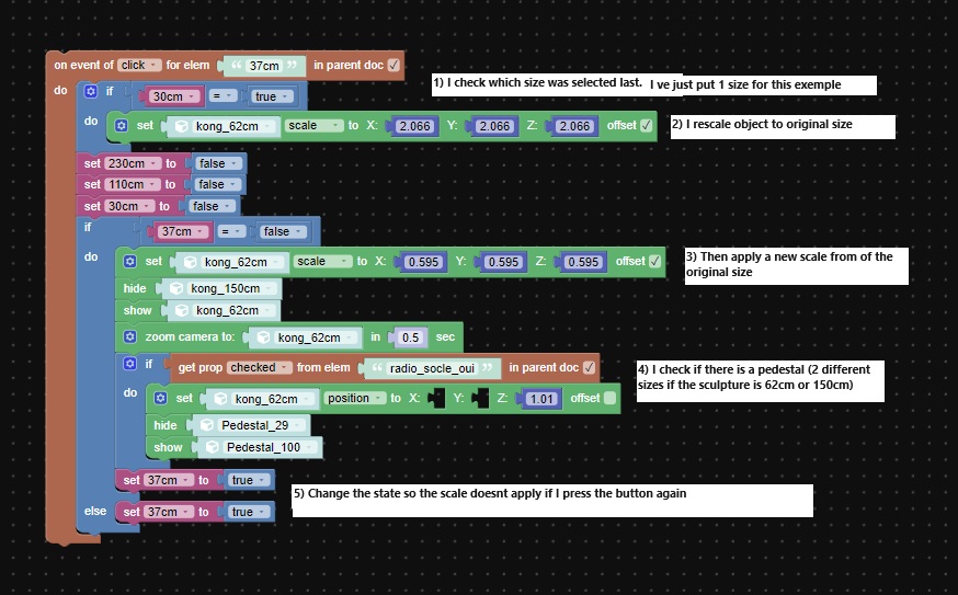

    So my best guess it to check the state of each size in order to apply scale to go back to the orignal size “Just set scale back to 1 (or any other value used initially)” and then scale to the desired size.

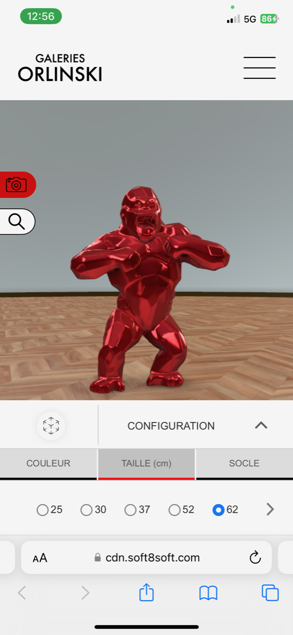

    You can check my appl below : I can get only the size 30cm and 37cm working yet..
    https://v3d.net/oku

    Here is my puzzle when I click on a size button
