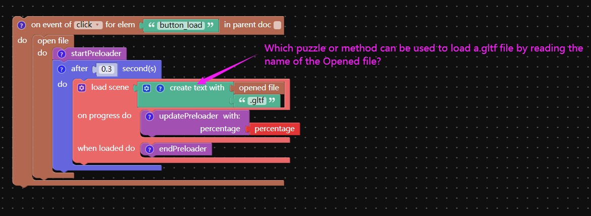

    Which jigsaw or method can load a.gltf file by dynamically reading the opened file name instead of using the name defined by DIV? As shown in the figure below

    hi,
    you can use a variable puzzle for that https://www.soft8soft.com/docs/manual/en/puzzles/Variables.html
    #51061
    nsxdjx
    HI,Yuri Kovelenov
    The file name spelling of the gltf object cannot be obtained through the opened file. At present, only the contents of the file can be opened, so the variable combination method of create text cannot be used. Is it possible to develop a puzzle that can directly obtain the object file name through the opened file。
