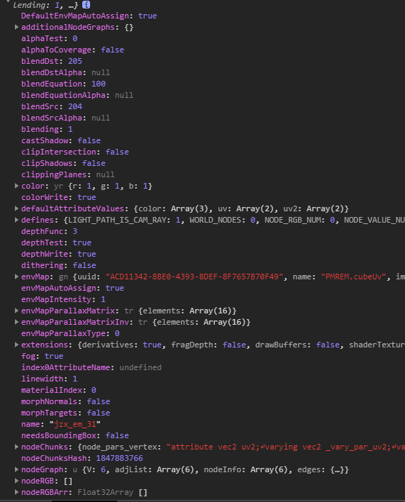

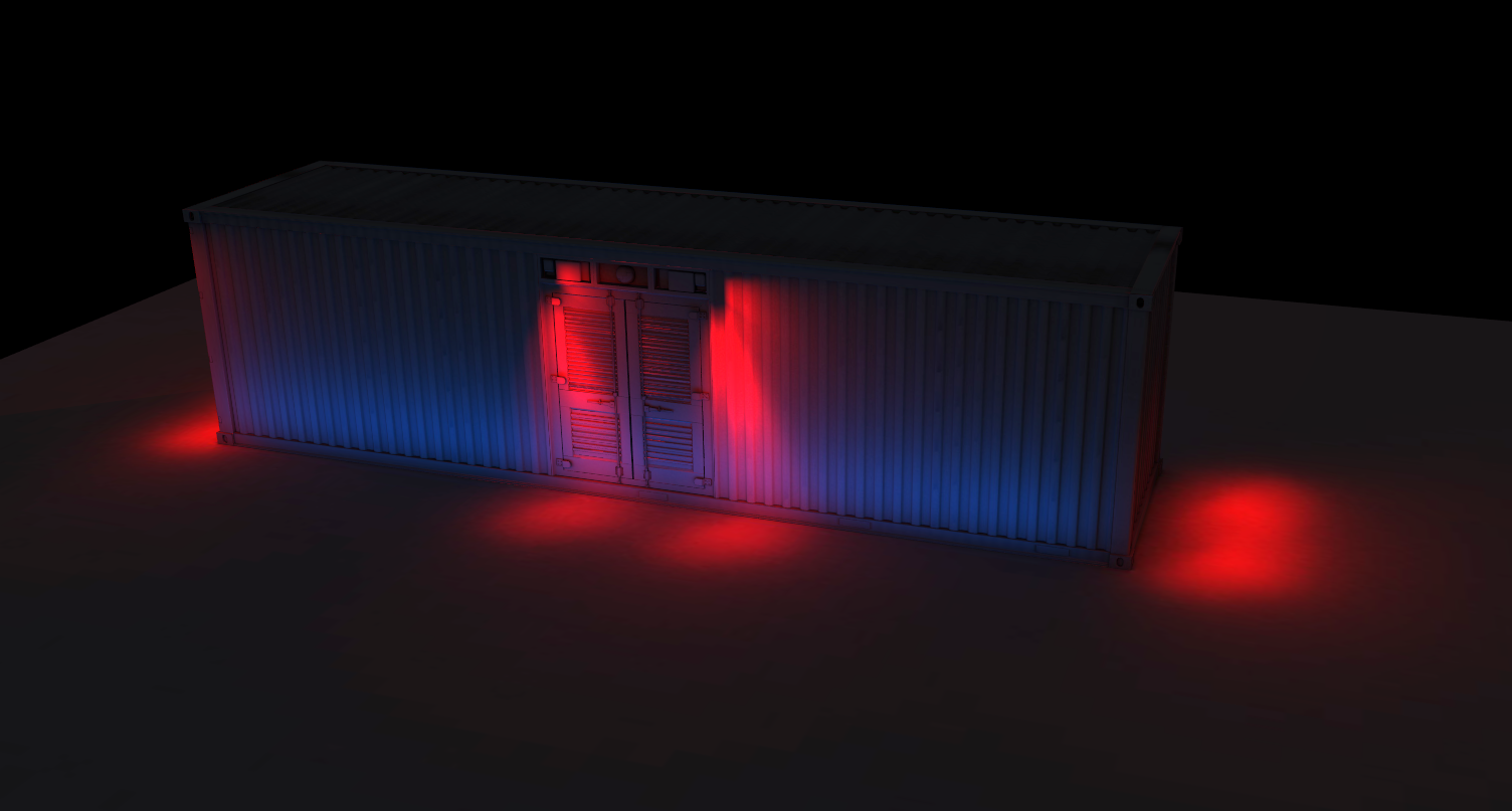

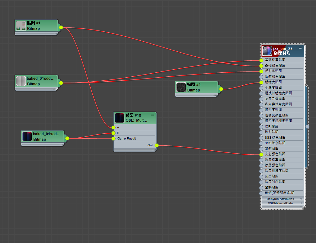

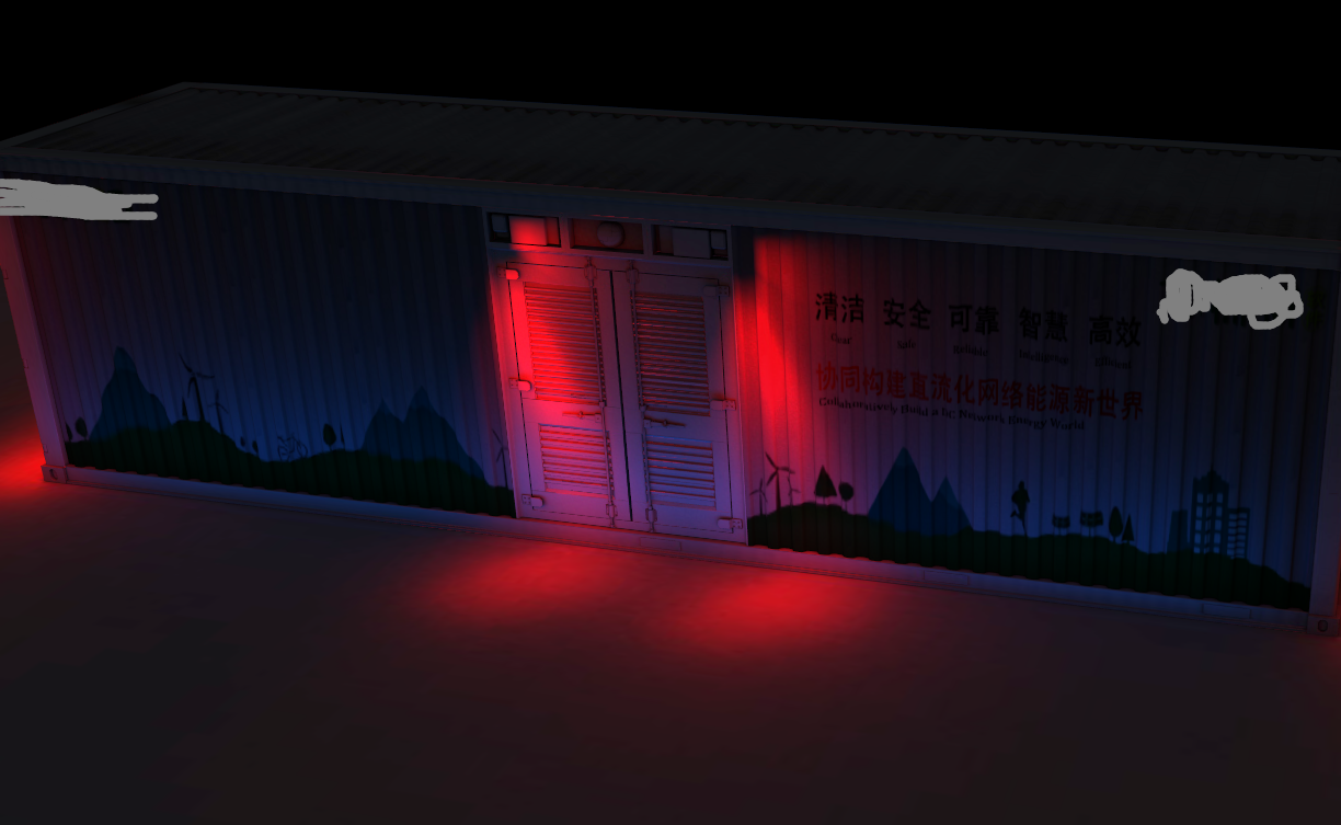

CustomerHow to export the lightmap correctly? I can’t find the lightmap channel on the final material through the console, and its material type is meshnodematerial. If it is pasted on the emissivemap, its final mapping effect is incorrect compared with the lightmap, so I connect a mixing node myself. Will this increase the material operation efficiency
2021-11-29 at 8:19 am #47326方伟 宾
CustomerWhat is the name of the parameter emissiveintensity? It is not found in the result of the console

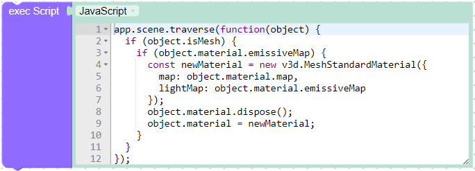

ParticipantAccording to this https://blenderartists.org/t/newbie-how-to-export-lightmap-for-gltf-2-0/1335887 light maps are not supported by glTF. But they are supported by THREE and V3D engines, so you can use this workaround
Light maps require the second UV map.
https://v3d.net/dqvInstead of
MeshStandardMaterialyou can tryMeshPhongMaterialorMeshBasicMaterial. They look different with light maps.Puzzles and JS coding. Fast and expensive.

Participantit will convert all the materials that have emission?
this script will find all meshes with emissive maps
what will be the new material names?
add this string to name the new material
newMaterial.name = object.material.name;Puzzles and JS coding. Fast and expensive.
