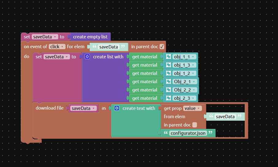

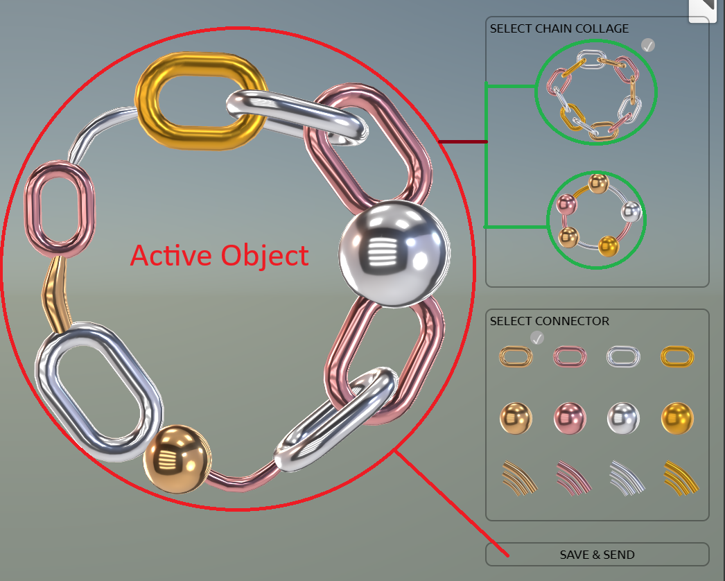

I have been trying to do this for a long time, but I can’t get the data from the active object. That is, when the objects are active and displayed on the screen, how can I get information from that object?
Tried working on different puzzles but just can’t seem to get it to work. Currently what is happening is if I show only the objects it only collects the data for those objects.source file

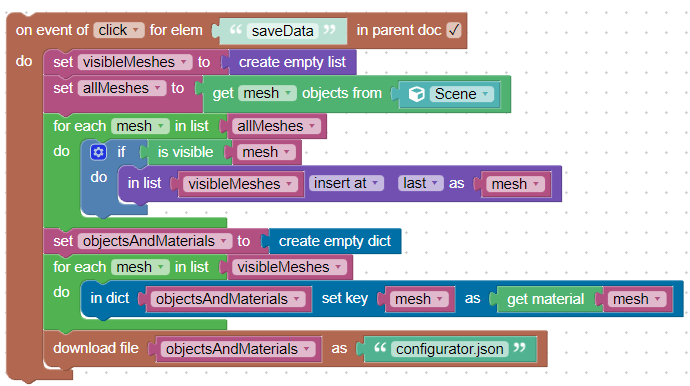

www.rana3d.com2024-03-02 at 5:05 pm #71280kdv
Participanthow can I get information from that object?
What kind of information do you want to get? Just material names?
2024-03-02 at 5:53 pm #71282
mashud008ParticipantAmazing
, it’s working great. really thank you KDV
is it possible to get more information from this object? like price, size, colors etcMashud Rana
3D Modeller | Rendering & Interactive Expert
www.rana3d.com2024-03-03 at 4:09 am #71285kdv
ParticipantIt’s possible to get any property of any object.

mashud008ParticipantThanks for your valuable comment. another ask, can you please setup puzzle for
the downloaded json file can be send by email.
Actually when I’ll click “save and send” the json file will send by email.Mashud Rana

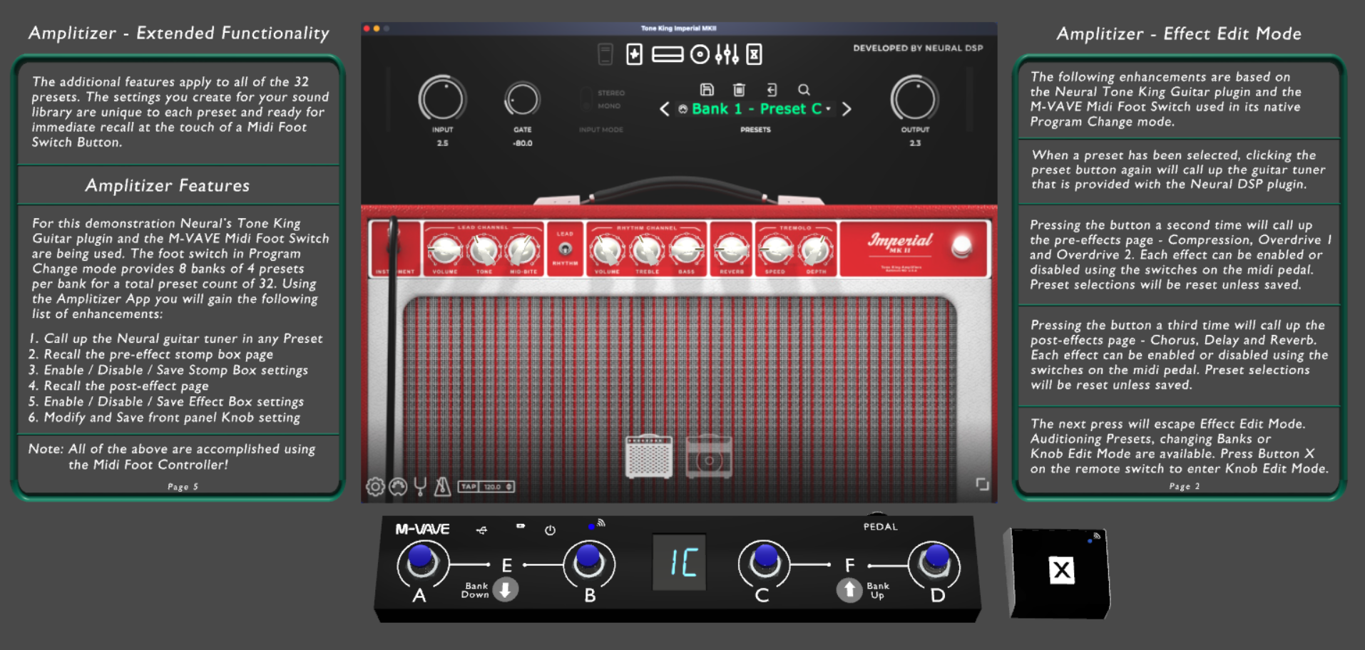

I saw your reply regarding extracting information from an object and will give your suggestion that you created for mashud00 a go. I posted a message a month ago but did not get any replies. In a nutshell my project is an interactive demo for a software based app that manipulates midi data. There are a total of 32 preset DSP amplifier setups and I’m using a set for 9 knobs to shared between the 32 presets. Every is working fine but I need to be able to store and changes made to those knobs individually by preset. I’ve made some headway with using dictionary functions but I need to write those changes back to a file for persistence sake. As mentioned I’ll try to use the info that you posted to see where I end up. I see that you have a gumroad store so perhaps my question is beyond my purview. The actual midi code is also suffering from the same problem which is writing or storing changed global variables.
I’ll attach an image of the amp face and related control knobs for what it’s worth.

As per my message yesterday if anything I feel like I’m too verbose. I came upbwith a rather crude workaround based on linked objects.
As far as using the dictionary function I am able to use “set key” to store the information I need and then use “get key” to restore the data. The problem that I’m encountering is with the “get key” command. If I try to execute it using a procedure that is associated with the button that contains the parameter I’m trying to update it essentially locks the object and does nothing. If I execute the “get key” using an “on-click” event from a non related object it works like a charm. I only guessing due to my lack of knowledge but is the non working issue have anything to do with the “read from” and “update to” fields being the same?If there are some general “rules of thumb” regarding the use of the dictionary function I’d be more that happy to listen.
Thanks again for taking the time for your reply. As I mentioned I have come up with a crude work around but I’m always eager to learn something new.
