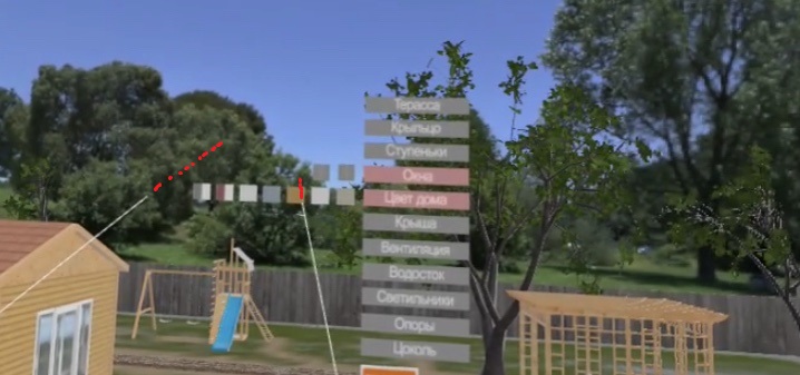

ParticipantYou’ll have to create a special UI for VR based on 3D objects.
Something like this

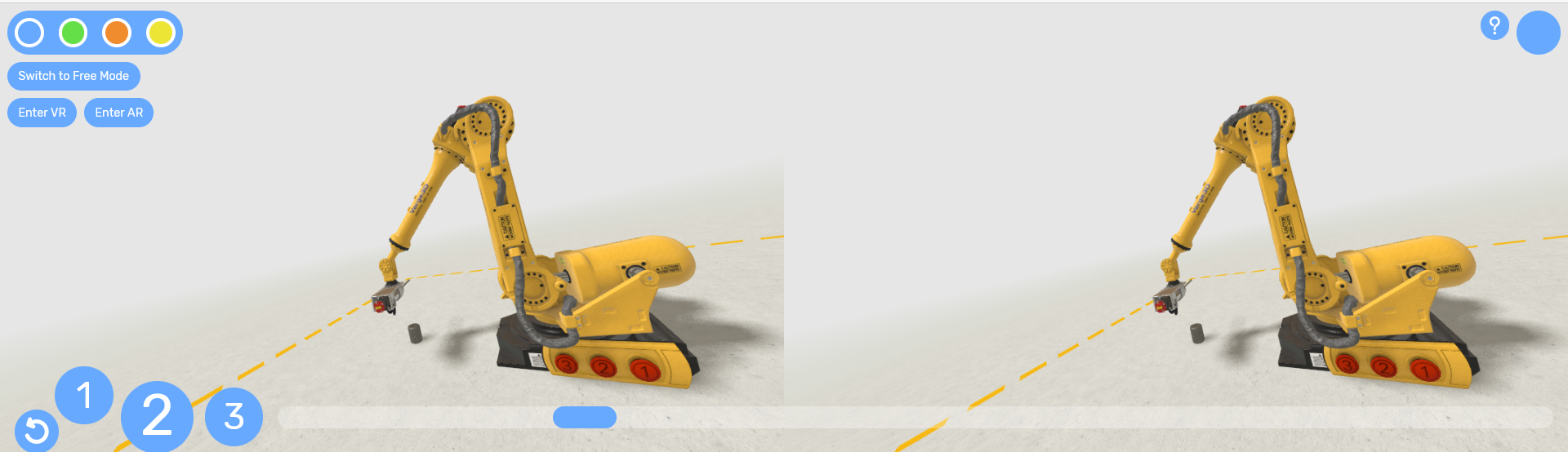

2024-01-22 at 7:26 am #69872as421465683
ParticipantThe image below is your official VR case study. After conducting VR tests, we found that the UI under the webpage cannot be properly displayed in VR. If we want it to display correctly and be operable, how would you achieve this? Do you have any relevant case studies?

Yuri KovelenovStaffHi as421465683,
Unfortunately the Web VR technology is not compatible with HTML markups. The only way to go is to use 3D objects positioned in the 3D scene. The above image by kdv shows this approach. Also check out another demo of ours called Virtual Reality for an implementation example.
