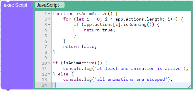

    and these names differ from the names of their objects? Then you should use scripting
    function isAnimActive() {
        for (let j = 0; j < app.actions.length; j++) {
            if (app.actions[j].isRunning()) {
                return true;
        return false;
    if (isAnimActive()) {
        console.log('at least one animation is active');
    } else {
        console.log('all animations are stopped');

    You cannot use the variable app in external scripts. This variable is declared in visual_logic.js only…
    The script above will work with no problems in the main section of puzzles, but will not in the init section.
    p.s. I’ve just noticed that this forum breaks the script ))) It hides i in the square brackets. I’ve updated the script by replacing i with j in the loop ))) The screenshot is showing the correct variant )))
