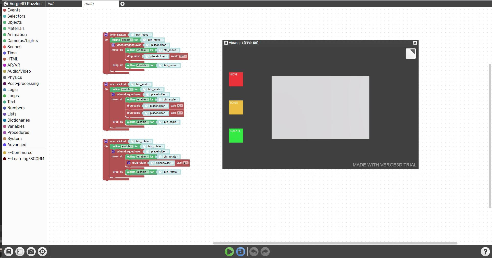

    I’m really new to puzzles and i have a problem.
    I have a simple app for moving, scaling and rotating an object using three different buttons which are using the ‘when clicked’ events. But at the moment, if i click on the move button and then i click on the scale or the rotate button, the events are triggered at the same time.
    Is there a way to change between a move, scale and rotate event so that only one event is triggered at a time?

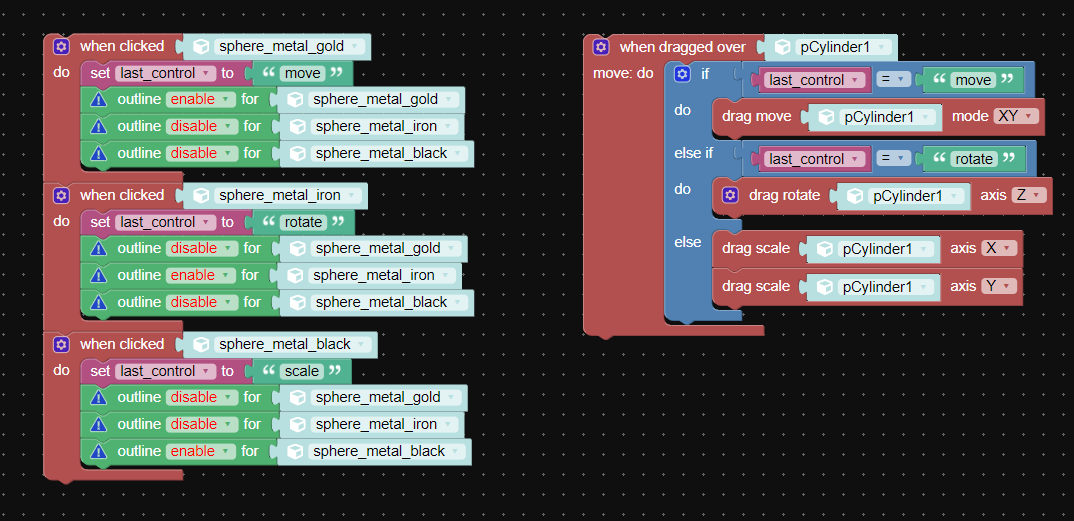

    you may make a variable to store the last clicked control and highlight it… and make one when clicked puzzle to control the 3 transforms according to the variable value B-)
    see the attached screen shot (just substitute with your values, I’ve used a current scene for demonstration)

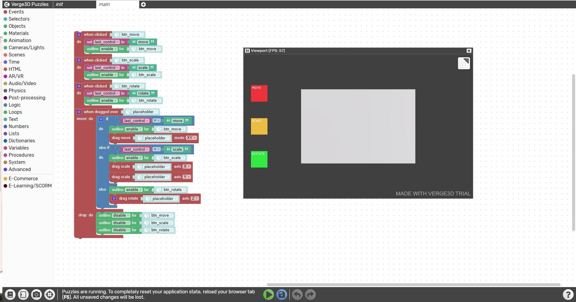

    JT
    Thank you very much Muhammad. :) That worked perfectly! :good:
    I have provided an updated screenshot of the puzzles i’m using, just in case anyone else might need to do this.
