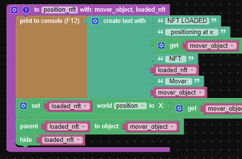

    I load some objects (as appended scenes) and this function correctly positions and parents them, but the hide command does nothing at all.
    I am not using the show command in any other part of my project.
    What’s happening here?
    Cheers
    #47550
    is this object a mesh or an empty?
    #47552
    grimmy
    The object is a mesh (I think?, its an imported gltf scene) and the parent is an empty. I’ve tried hiding both the empty and the mesh/imported gltf but nothing happens.

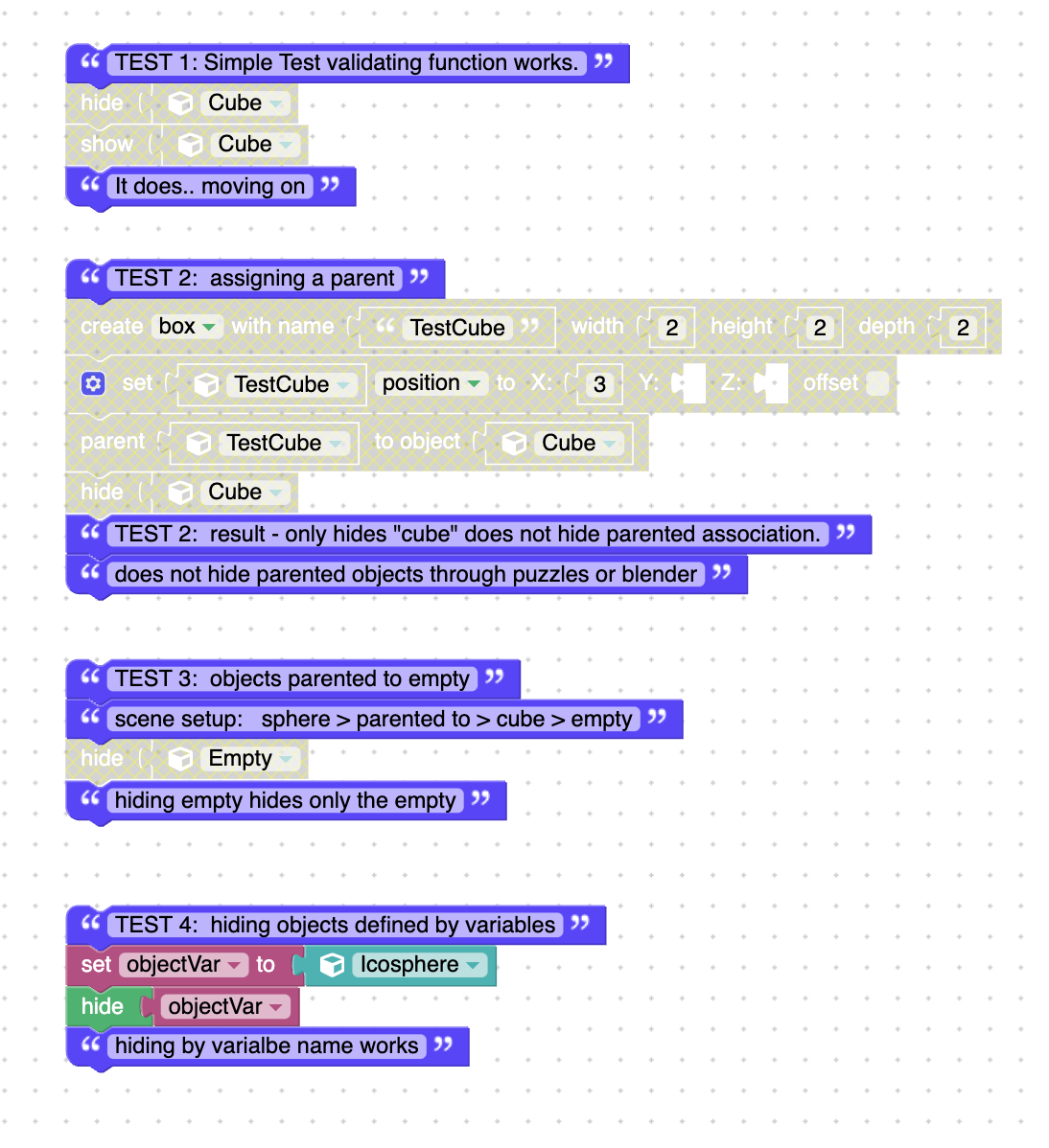

    Ok…after looking at this a bit and performing a few tests. The HIDE function is working as expected. See attached Puzzles tests.
    The last test is a test where a variable is assigned a variable and the variable is used to hide the object.
    For this to work the variable has to be an object/mesh.
    So the question is what is “load_nft”. Are you certain that its an object and not an image or texture, string or other data type.
    If you share your project I am sure it could be quickly determined.
