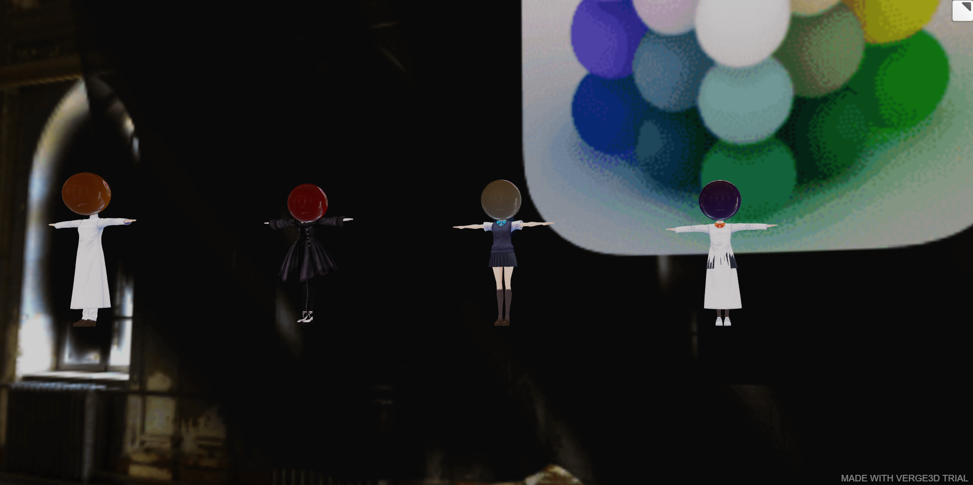

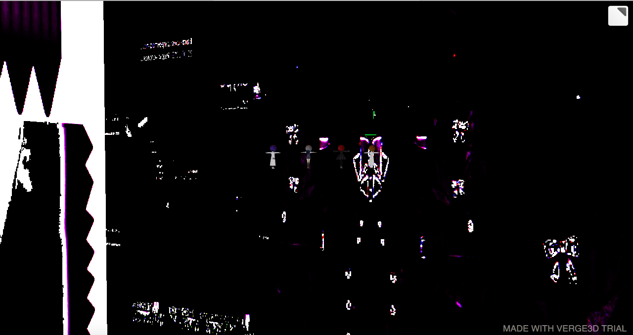

    Hi!
    Why in Blender everything is ok, in Verge :unsure:
    Look screens
    1 preview in Verge
    2 preview in Blender
    How can i fix scene in Verge?
    #38316
    ilzh
    in fact i want to make them the same.
    verge like a blender.
    how can i do it?

    #38364
    ilzh
    Seems like it’s work for me fine. Have you tested your scene on another pc?
    So, my friend (Linux and Windows) is all right, the same screenshot as yours. My MacBook does not have enough power to process textures correctly and because of this, such loops appear.
    The question is how to lighten the scene? Now I understand that four characters is a lot, probably a couple at most.
    Maybe you know some other tricks on how to lighten the whole structure?
