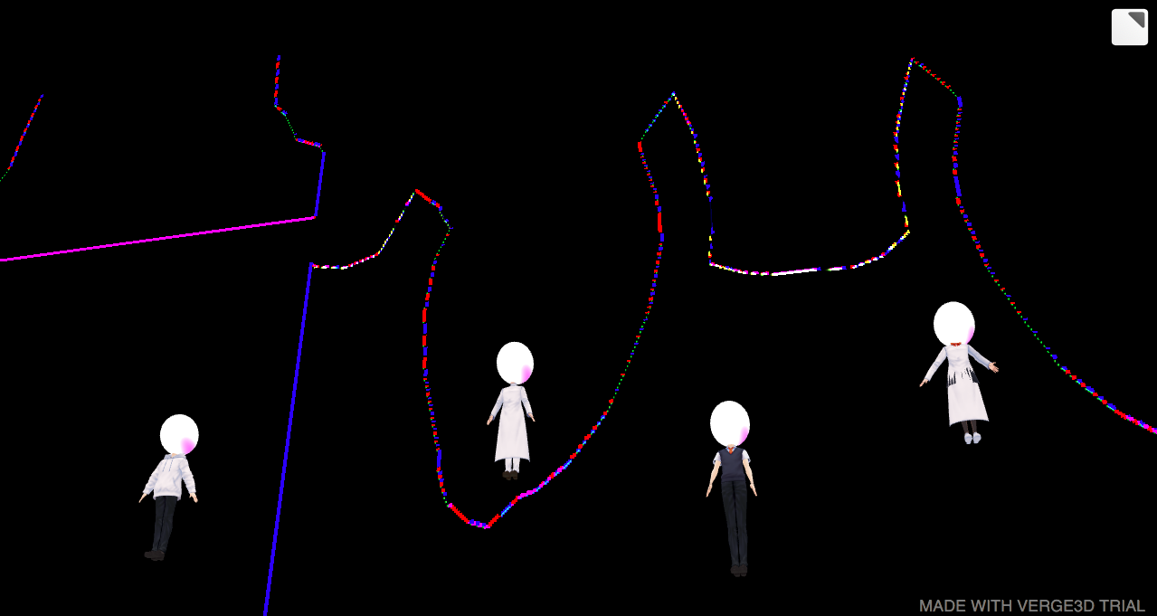

Do you know how to glue all the details of one character into a single, solid object in a blender?
It is necessary for Verge, wright? I do not need their separate parts, armatures and fittings att all.Animation is not needed here either.
I want to get 4 full characters at the output as they are now in the picture (printscreen here) and in the Verge write ways for them, transitions to other locations of my site (each character will open another site or scene in my site by clicking on it)
For solid characters I also need the scene / world itself as I did initially and as it is in the screenshot here.
Here is the key question!

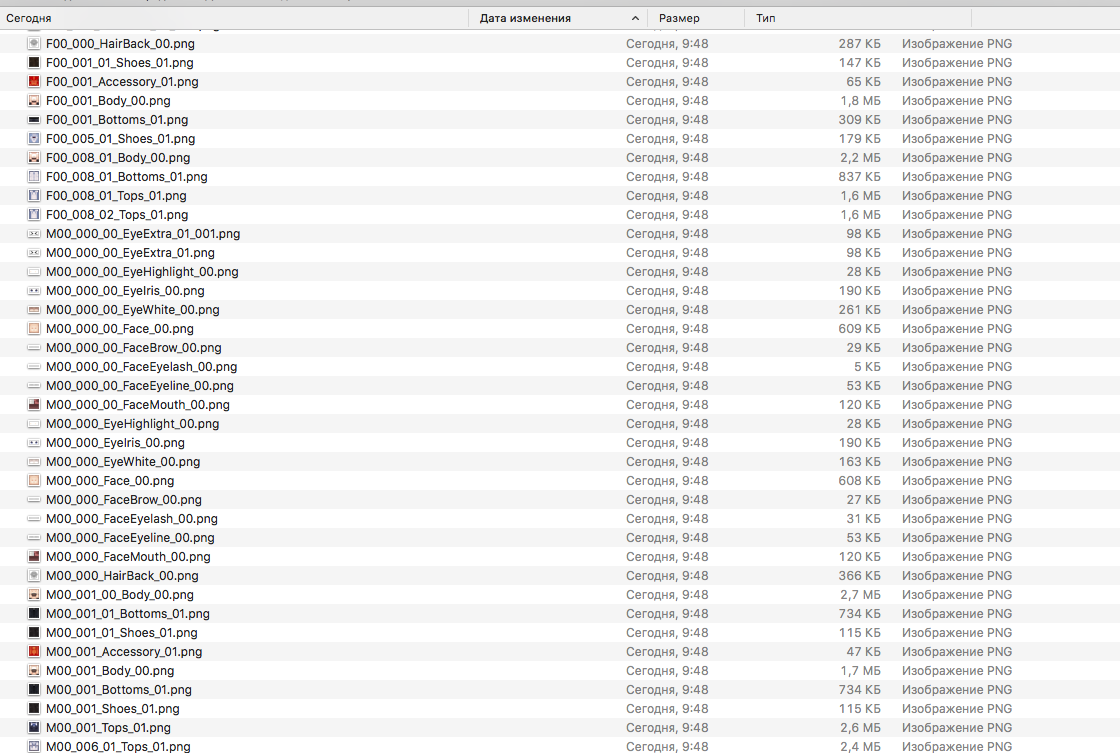

5. Once saved go back to the App Manager, locate your TestProject file, open…you are good to go.Same bshit (
I did that way but it doesn’t works
BUT I GOT A LOT OF PICTURES HERE and now i think i should replace all of them to the folder with my app
Look

ilzhParticipant
i did it and it works)

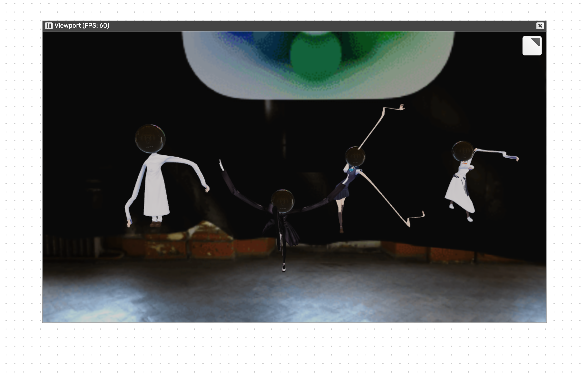

what should i do here? buy new PC?))1) Blender
