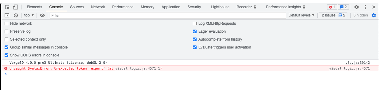

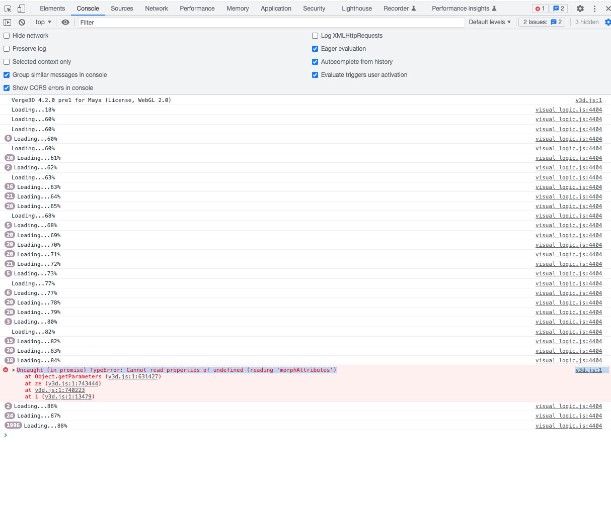

Ok. So I replaced the v3d.js with the new one, but if I just refresh the app browser window I get the following error in the browser console:
Uncaught SyntaxError: Unexpected token ‘export’ (at visual_logic.js:4571:1)
Then after refreshing the App Manager browser window I saw that I had to update the application, which I did.
After that I deleted all the batched geometry inside of puzzles including the one I had in the append scene / when loaded do puzzle.

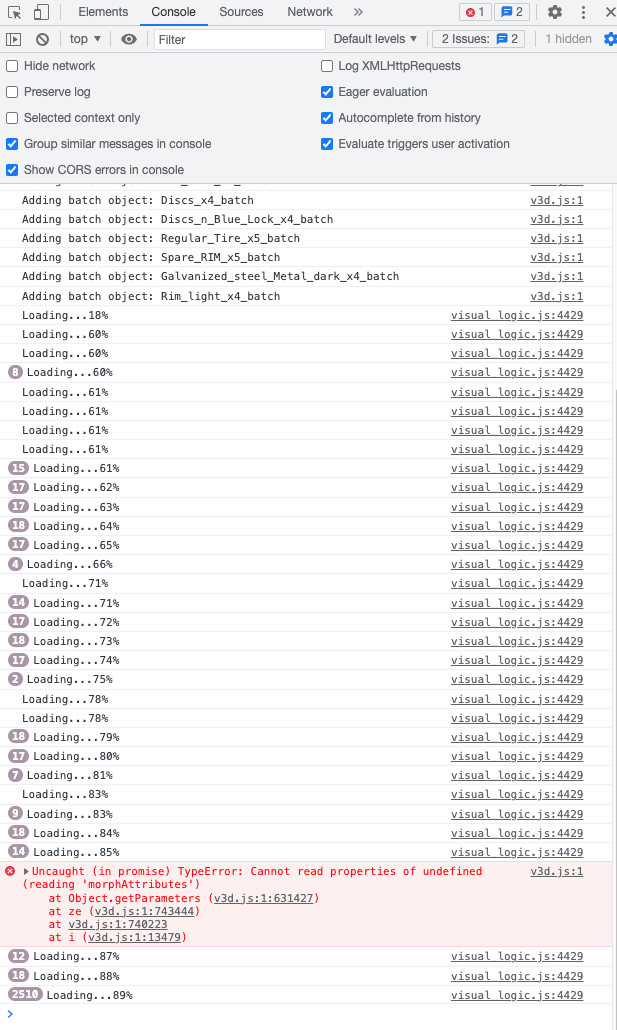

Still, after testing it out I get the following browser console error with endless count loading:
v3d.js:1 Uncaught (in promise) TypeError: Cannot read properties of undefined (reading ‘morphAttributes’)
Still in a pickle…

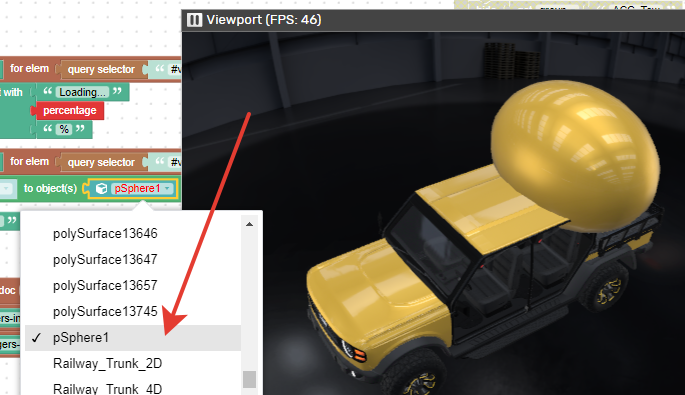

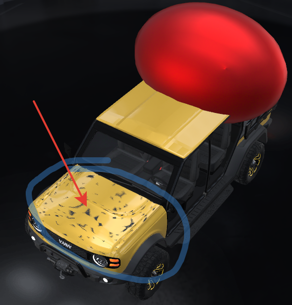

ParticipantHere is your problem: you assign a material to all objects in a group, but this group contains not only meshes, it also contains empty objects that are not supposed to have a material.
And you can add this script somewhere in the begining
It will remove this effect
And you’d better not use geometry batching at all. It increases tris count significantly. A dubious optimization…

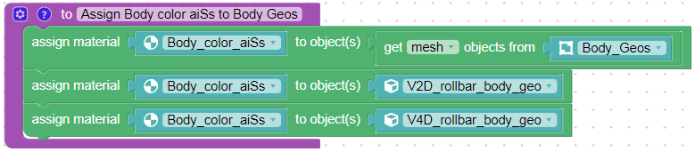

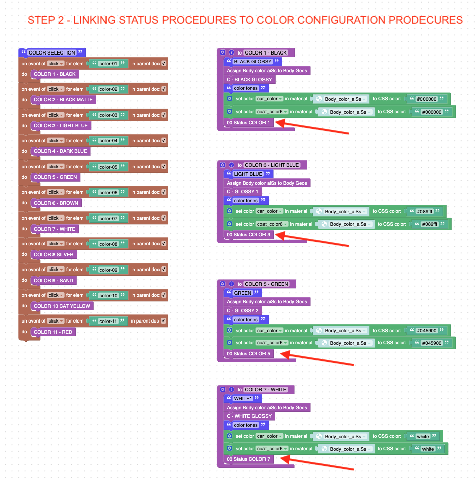

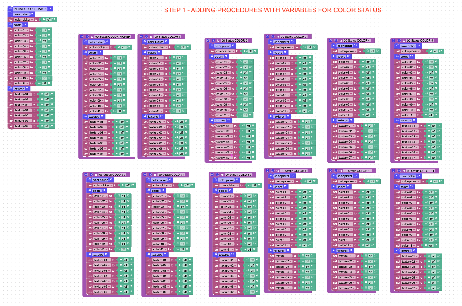

Yo definitely rock!I managed to set the color update with variables and procedures, where I first made a list of procedures with a variables for each color that stated if was on or off. I also created an initial state of variables for this.
Then I added these status procedures to the prior color configuration procedures I already had which were linked to the on event of click puzzles.

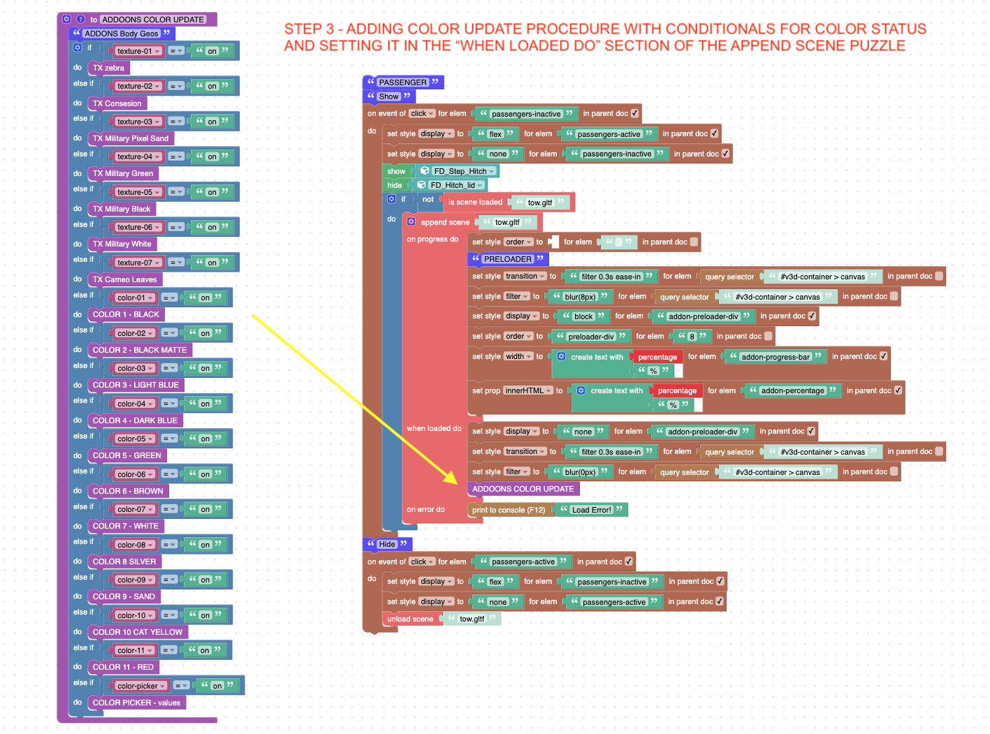

Finally I created a procedure with conditional that referenced the state of the active color status. I then used this last procedure which I named “addons color update” in the “when loaded do” section of the append puzzle.
And voila! PROBLEM SOLVED! … All working smoothly now.
