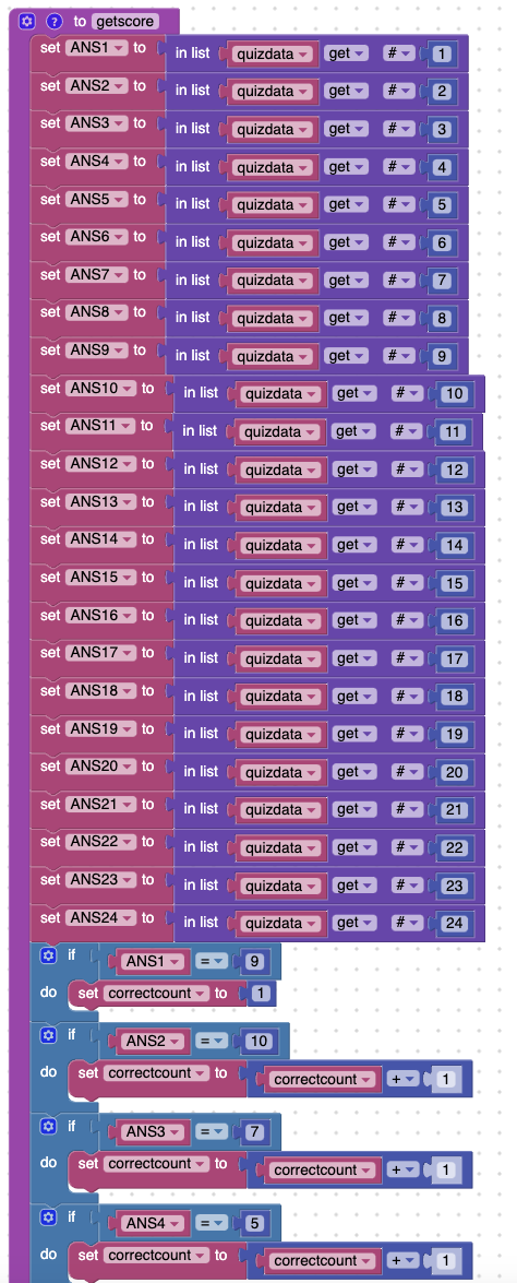

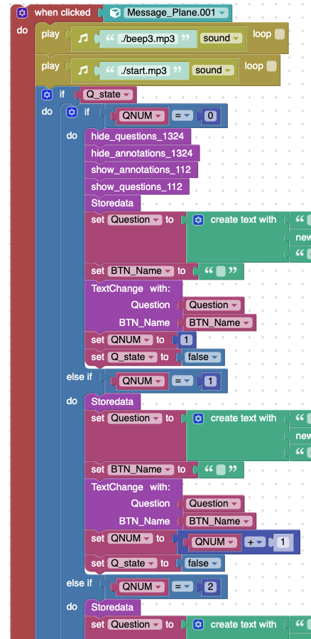

    I attach 2 stills of my puzzles, one with the panel which is use as trigger to store the info everytime the user clicks to send the info and the other the procedure that i use to check the correct answer and store it in the list.

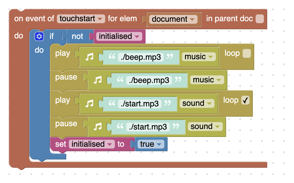

    If you haven’t already you should initialize the loading of the sounds. Preload your sounds in your Init Tab. This will insure they will be ready to play. If you also plan on letting people play this on mobile devices you should create a touch even to preload them for mobile.
    Once these items are done they will playback as fast as possible since they will be in memory.
    Lastly, I would suggest putting your audio playback call into a procedure and prioritizing the playback so that these procedures are only called when necessary not on click. This may be your intent…I don’t know your design requirements.
    Currently, you have a beep then a start sound in the onclick. Depending on the computer and editing of the tracks these may play very close to each rather than the spacing you intend. Since I don’t know how you are really using them you and you are triggering them simultaneously, you might want to just edit the sound into one file and save yourself some memory and load time.

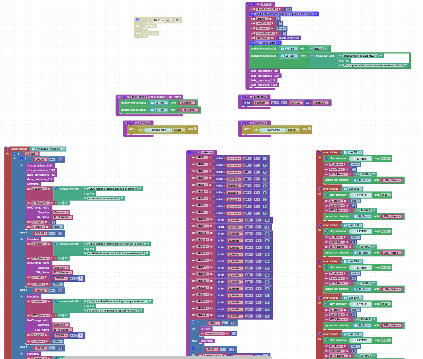

    I removed all my sounds and let (for testing) my 2 right/wrong sounds.
    These are preloaded in the init tab, and made a procedure calling them.
    I placed them in the first question, just to try this.
    The sounds plays when all the 24 questions has been answered, no when the send button is clicked for the first question.
    I attach a screenshot with my puzzle set up again with the config, as i’m convinced that i’m doing something wrong but i cannot see it :-( :-(
    Hope you can help me to get this thing work.

    in your puzzles the sounds are played when the ‘getscore’ procedure is invoked. If ‘getscore’ is triggered in the end of the quiz, the sound will only be played once.
