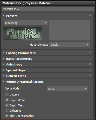

Ivan LyubovnikovStaffAh, yes, that’s why you don’t see any textures.
Verge3D exports 3d data in the standard GLTF 2.0 format, but also extends it with additional features, like node-based materials or some specific camera/light settings. Those features are not supported by other gltf viewers and that’s why you can see the difference. But this is related to both the GLTF and GLB export, so I’m not sure why you have issues only with GLB.
For Physical Materials in 3ds Max you can try to enable the “glTF 2.0 Compatible” option:
There’s also a bit more information about that in the FAQ:
https://www.soft8soft.com/docs/manual/en/introduction/FAQ.html#what_is_gltf
https://www.soft8soft.com/docs/manual/en/introduction/FAQ.html#gltf_materialsAttachments:
